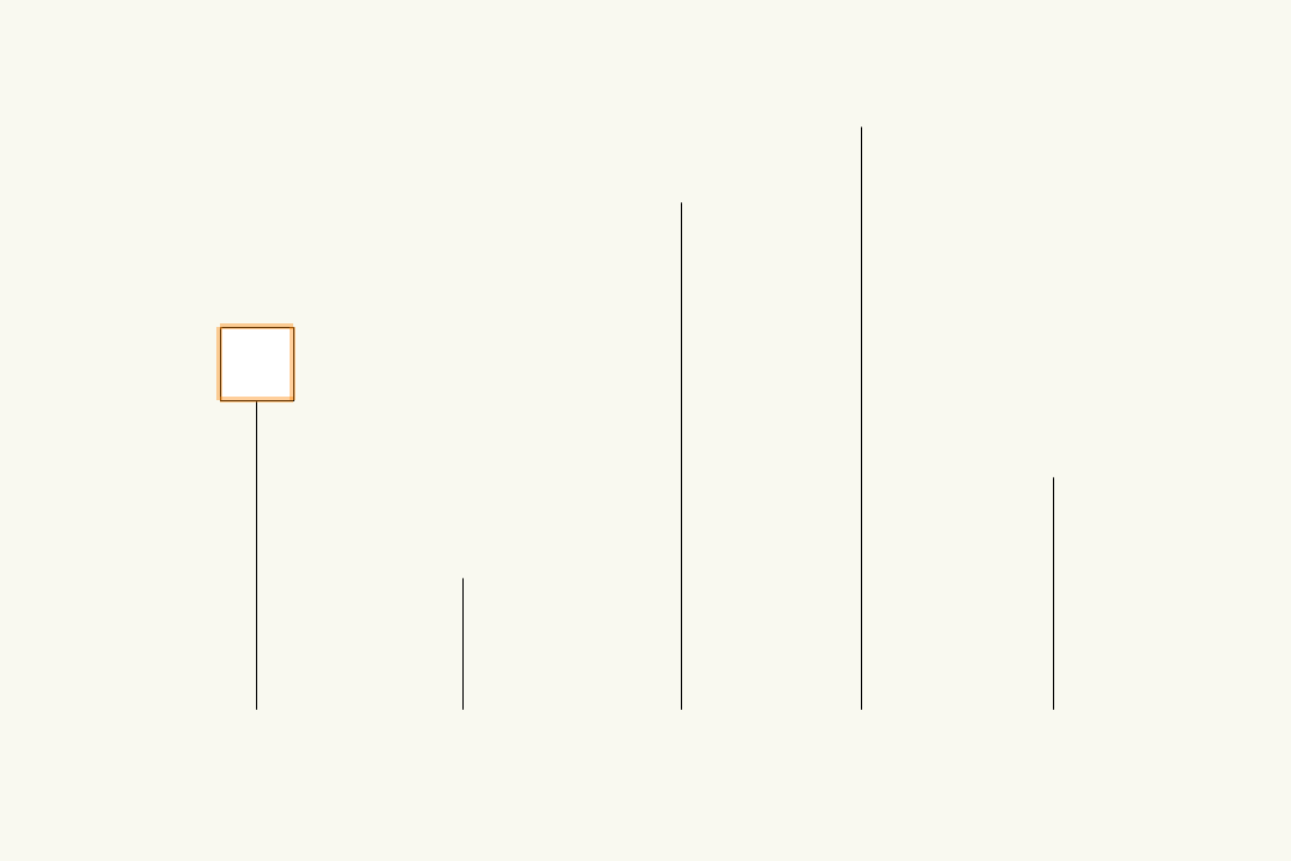

@Hugh Chapman - Did something like your suggestion - see attached
On 5/12/2025 at 1:25 PM, Hugh Chapman said:
perform a ‘run’ of copy by point. Say for some reason I need to put a square on top of all these random height ‘sticks’.
01 = Move by points holding the option key ... this creates the duplicates
     Double click on each line to place.
02 = Create a symbol "square" with the insertion point at the bottom
Make it th active symbol and click away where needed
We use a lot of symbols (thousands !) so we often make symbols of things as a matter of course - They behave differently - though they are harder to screw up. Easier to count, and best of all VW will find them via a worksheet !

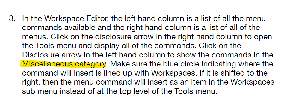

  • 0
1 hour ago, Pat Stanford said:
If you specified a Category when you created the menu command it could be something other than Miscellaneous. That is just the default if you don't specify something else.
Many thanks @Pat Stanford somehow I hadn't grasped that I needed to make the plug-in menu command before adding it to a workspace!
I've got this working now with
Ctrl-Shift M - Move by Points in Move Mode
Ctrl-Shift C - Move by Points in Move and Duplicate Mode i.e. Copy by Points
Ideally I would like to assign just "M" and "C" as single key shortcuts to invoke MbP in these tool modes but this doesn't appear to be possible in the Workspace Editor?
It is not possible. Single Key shortcuts can only be applied to Tools. And as you already found out, scripts in tools to not run until you click into the drawing with the tool.
I also note that there doesn't appear to be a way to save custom commands within the Plug-in Manager or Workspace Editor. I wonder if VW would consider streamlining the process of transferring custom commands between versions.
The PIO you created should have been created in your User Folder. When you upgrade VW, you can use the Migration Manager to move your user folder to the new version. This will move a copy of the PIO and of your custom Workspace with the shortcuts to the new version. Since this is a very simple script it is unlikely to break, but some more complicated scripts may not run properly in a later version of VW from what they were written in.  Most will be fine.
Many power users do use custom scripts. They are especially common in the Entertainment industry where there is a small industry about 5-10 people who sell packages of custom scripts to enhance users experiences.  Yes, If you don't like the way VW works, you can change many things using scripts. But you have to be willing to learn scripting. There are some of us here who love to help new scripters. But we grow tired rapidly of people who just want things done for them without making the effort to learn how to do it themselves.
