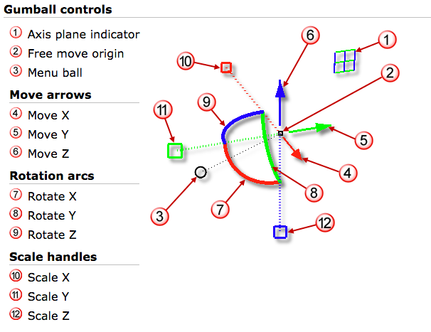

Any chance future releases of Vectorworks could include a gumball?
In my view the gumball might be the most revolutionary feature in drawing and modelling software.

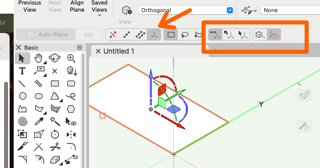

@Hugh Chapman In the link that Dave Donley posted and as Pat Stanford suggested, the 3D dragger is already in the following tools in Vw2025:
Quote
The Edit Subdivision tool, Reshape tool, and Selection tool provide access to a 3D dragger that allows you to perform a variety of free-form modeling operations on certain 3D objects, including subdivisions, 3D polygons, NURBS curves and surfaces, and solid objects.
Note that it is not available in all tools, so if you are looking for it to be application-wide on all tools, you will be disappointed.
As far as your statement that the “basic drawing functionality is not very good”, I think you’ll find that once you learn to properly use Vw it can perform as well as any of the other applications you mentioned.
In case you haven’t already found it, the largest repository of training material for Vw is the Vectorworks University portal. You’ll find a bunch of tutorials which can help you get up to speed on basic drawing functionality, both 2D and 3D.
