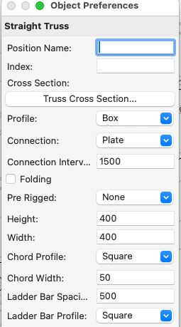

Vectorworks, Inc Employee Scott C. Parker Posted May 8, 2025 Vectorworks, Inc Employee Share Posted May 8, 2025 Hello Alper, welcome to the forum. The symbol libraries are almost all based on manufacturers' sets of items. Do you have a particular truss in mind? Can you provide a brand and model name? There is also a "Straight Truss" tool where you can specify the dimensions of truss. Quote Link to comment
Alper Posted May 10, 2025 Author Share Posted May 10, 2025 Thanks Scott. How can I add magnets to the truss which I created from the straight truss tool? Quote Link to comment
Vectorworks, Inc Employee Scott C. Parker Posted May 11, 2025 Vectorworks, Inc Employee Share Posted May 11, 2025 13 hours ago, Alper said: How can I add magnets Here's some documentation on magnets. https://app-help.vectorworks.net/2025/eng/VW2025_Guide/Braceworks/Placing_magnets_manually.htm?rhsearch=magnets&rhhlterm=magnets magnet Quote Link to comment
