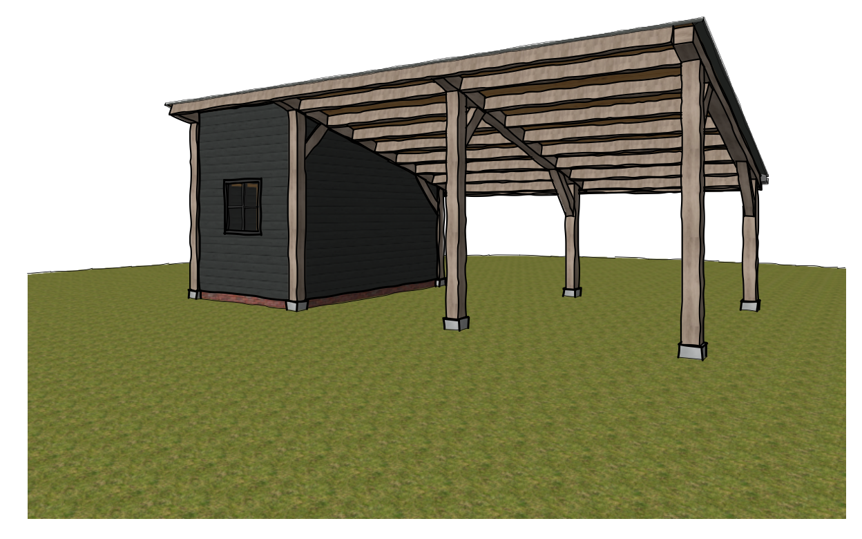

PvWarch Posted May 7, 2025 Author Share Posted May 7, 2025 Hi Marissa, Thank you for your quick reply. Sounds good, but I hope it does not get too complicated. My idea was to be able to use POI's in Marionette to make it easier to setup a more complex model. For example a smal shed. See attachment. So being able to program this with a few parameters like length, height, depth and roof angle for example. Quote Link to comment
Marionette Maven Marissa Farrell Posted May 7, 2025 Marionette Maven Share Posted May 7, 2025 Definitely theoretically possible. Ideally you'd define the shapes of the SMs first, and then duplicate them along paths. There's currently nothing in our default content that does this right out of the box, but it should be a simple enough network. Quote Link to comment
PvWarch Posted May 8, 2025 Author Share Posted May 8, 2025 I already tried to make a marionette network to model this shed, but it gets a bit complicated. I am struggling with all the angles (especially the braces) so i thought that it would be easier to use POI's in a network. But when I read your reply, this may not be the best way to do this. I also want to make a quantity takeoff to be able to calculate the cost of building the shed. Thought this would be easier when using structural members. See attachment for my (messy) network. marionnet carport 20250505.vwx Quote Link to comment
