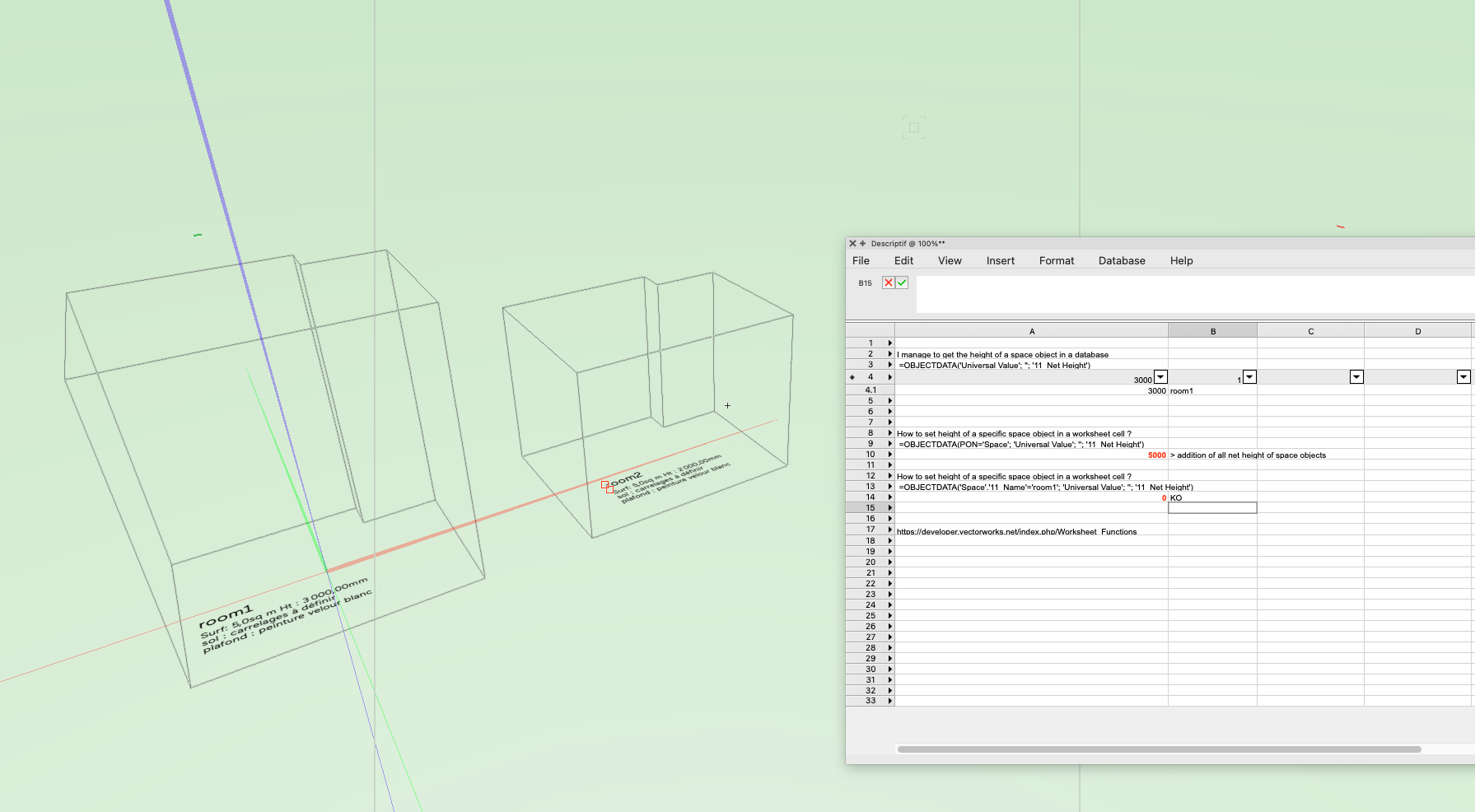

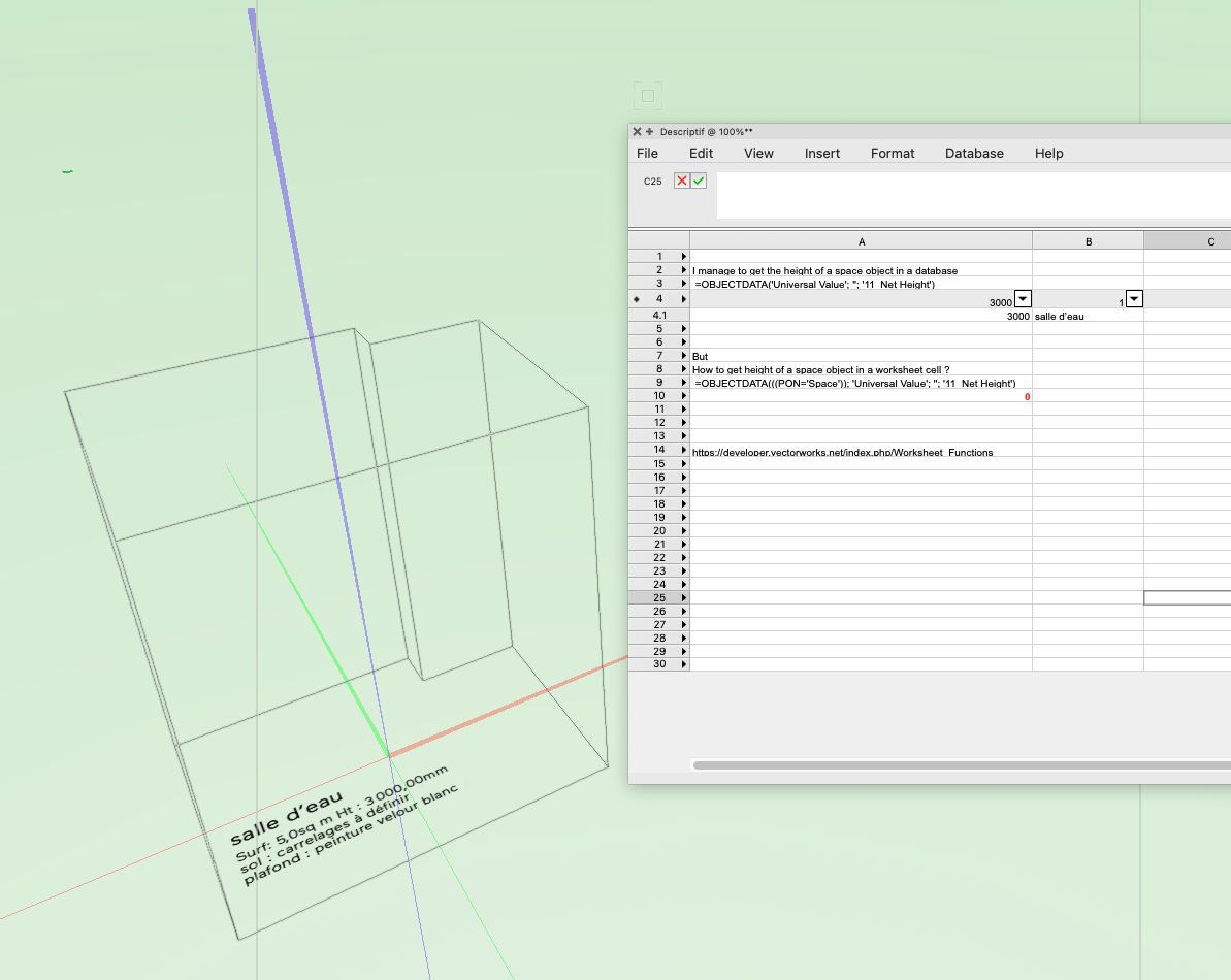

Indeed, if I remove the parenthesis around PON='Space' it works (but I don’t understand why we can’t have parenthesis which were here …)
But in a file where there is more than 1 space objects (which is common) I don’t manage to deal with the first argument of the OBJECTDADA command so it is more specific to only one space object.
For example here, calling the space object named "room1".
Any idea ?
(I attached a updated Vectorworks file)
Vectorworks Space Net height.vwx
Link to comment
  • 0
Hey @GatRed
=OBJECTDATA(PON='Space' OR ('Space'.'11_Name'<>'room1'); 'Universal Value'; ''; '11_NET HEIGHT')
work, … but I don't know why.
For me it seems like BUG, I would expect that:
=OBJECTDATA(PON='Space' AND ('Space'.'11_Name'='room1'); 'Universal Value'; ''; '11_NET HEIGHT')
I fill a BUG-Report fort that.
Greeting
Tobi
