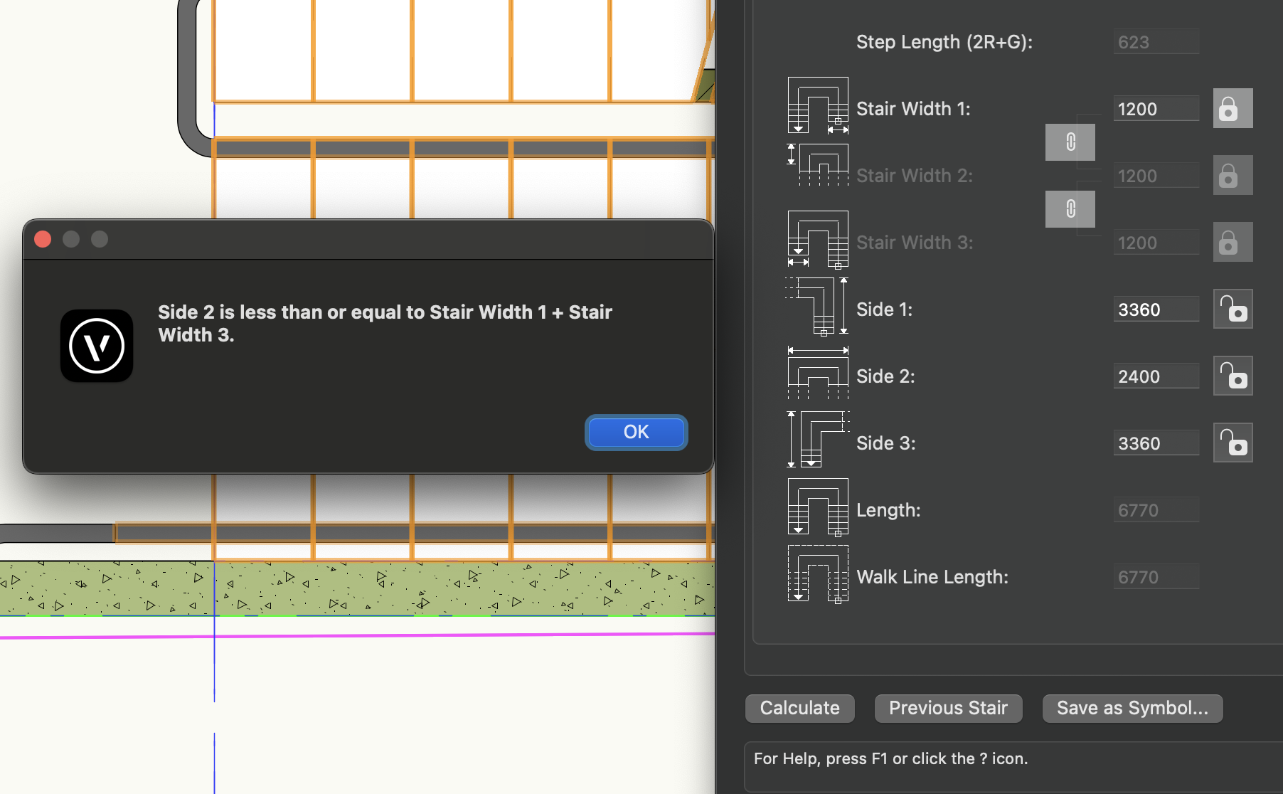

Hi,
In an instance where you have a store below an external concrete stair and you need that store to be protected from the rain, then a stairwell should be zero.
I wish for Stair Width 1 + Stair Width 3 = Side 2
Or for example:
1200 +1200 = 2400mm
Am I forced to have a 1mm gap to satisfy this rule?

The other 'contraint' we would like to see is the no. of treads (denoted 'risers') in each flight.  There should be an option to always keep them equal.
We can lock the number of treads but not make them equal as a default.
The most annoying thing about the stair (one of the most annoying things) is that if you choose to make the stair completely 'parametric' and for example control it's height be storeys, etc, tread are added to or subtracted from one flight and not both, at least it does for me, and this would simply never happen.
And nothing I can see in the current stair configuration would help constrain the number of flights.
Hoping someone can prove me wrong on this one.
