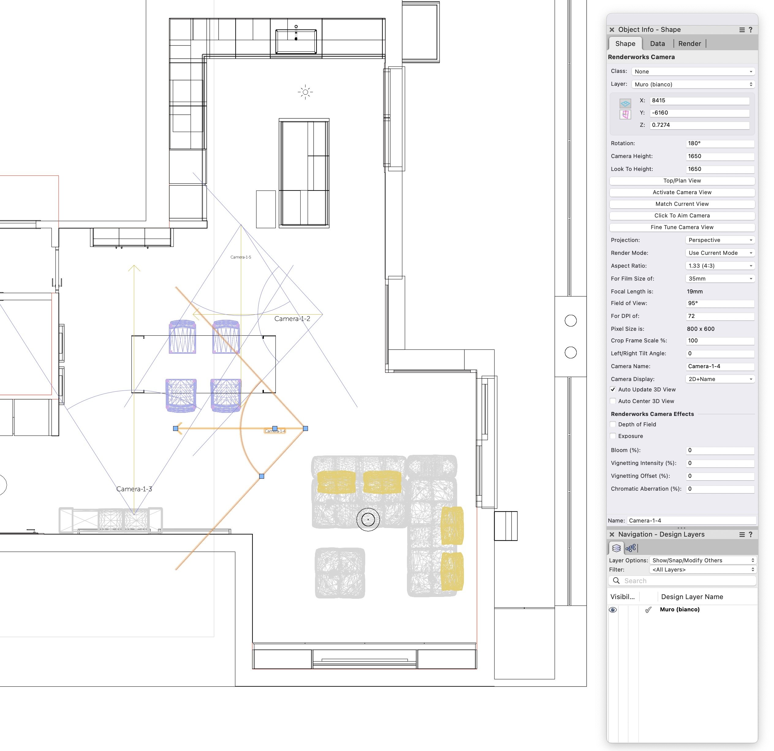

I have put the camera at 165cm, pointing straight... see screen-shot of the set-up.
Anyone having the same issues or anyone know how to fix this?

Can you share your camera setup or one of the images?

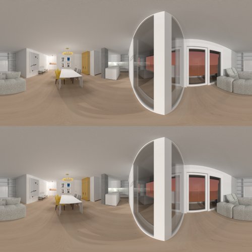

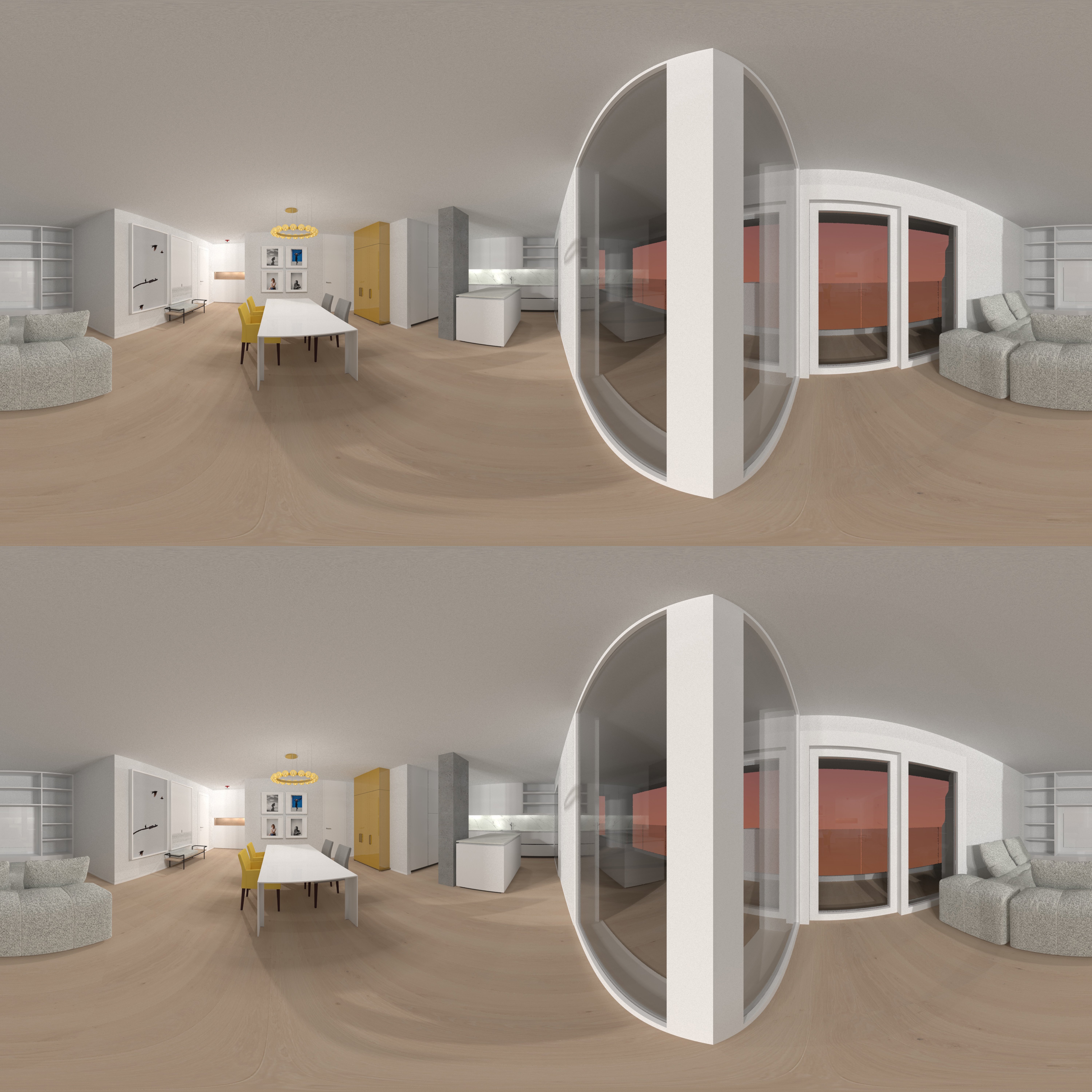

For the Stereoscopic image, I tried to export 2 panoramas moving the camera point-of-view 2"-3" aside... I will try a better result, but the main issue is the off-scale feeling.
Quest browser does not work with Panoramas, I tried that too. I download the Pigasus because a friend on mine, who uses 3D Studio, suggested it.
See screen-shot attached... and a panorama image (which is a test of a stereoscopic side-by-side).

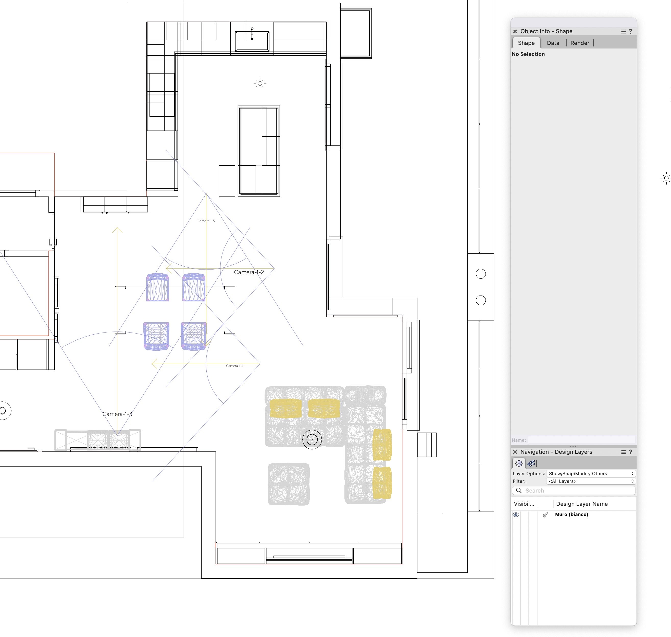

Try two cameras,
3" apart and then have them converge at 30'-0" away.
If it still looks goofy, move the camera apart by 1/2" increments.

What do you think about my camera set up? Do you see anything off?

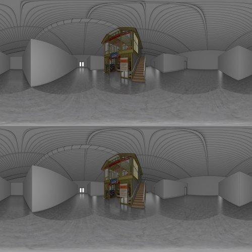

JPS is a file format standard created to help stereo apps use two separate images in one file with some encoding to help the app figure out how the two images go together.
I created my win Photoshop after stacking the two panoramas on top of each other.
In the Skybox viewer, both versions ( the JPG and the JPS) behaved the same. So the JPS is not required.
Looking further into it, I don't think the camera parameters make much of a difference, those settings probably get overwritten when you export the panorama. The export only seems to use the eye height and direction to center the panorama.
So, I think fine-tuning the distance between the two cameras is likely the key. Secondly, the convergence is optional. Some folks say you should keep the cameras parallel, but I think it depends on your total focus distance.

I have tried your panorama image on my Quest 2, but the scale looks a bit off... especially when I look at the stairs, they look small... or when I turn and look at the corner walls behind, they look big... do you feel the same?
Would you mind share your set of the camera used for your Panorama?
