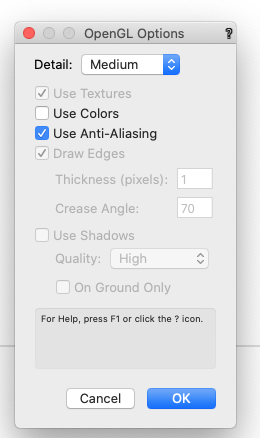

Christian Fekete Posted April 10 Share Posted April 10 The option to setup OPENGL with shadows is greyed out, any reason for that? I have lights on the lighting plan 250217 30 High Wood Rd SD4.vwx Quote Link to comment
0 Vectorworks, Inc Employee Dave Donley Posted April 10 Vectorworks, Inc Employee Share Posted April 10 Hello @Christian Fekete this would be some basic graphics support missing on the video card. Did this used to work on this computer? If you were on Windows I would recommend updating graphics drivers. On the Mac the drivers come with macOS, you might make sure you are using the latest minor version update for your major version macOS. 1 Quote Link to comment
0 Christian Fekete Posted Tuesday at 04:52 PM Author Share Posted Tuesday at 04:52 PM Previous drawings are also not showing properly anymore. I know I used a malware software to clean up my hard drive and this happened right after. Should I reinstall vectorworks to make sure? Quote Link to comment
