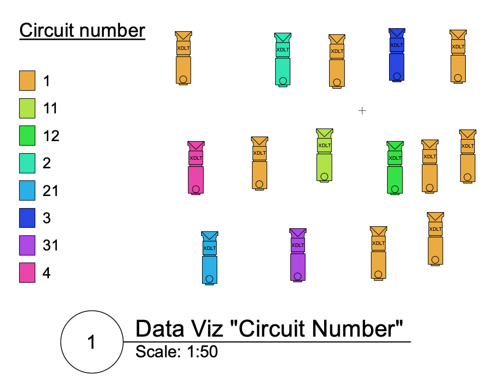

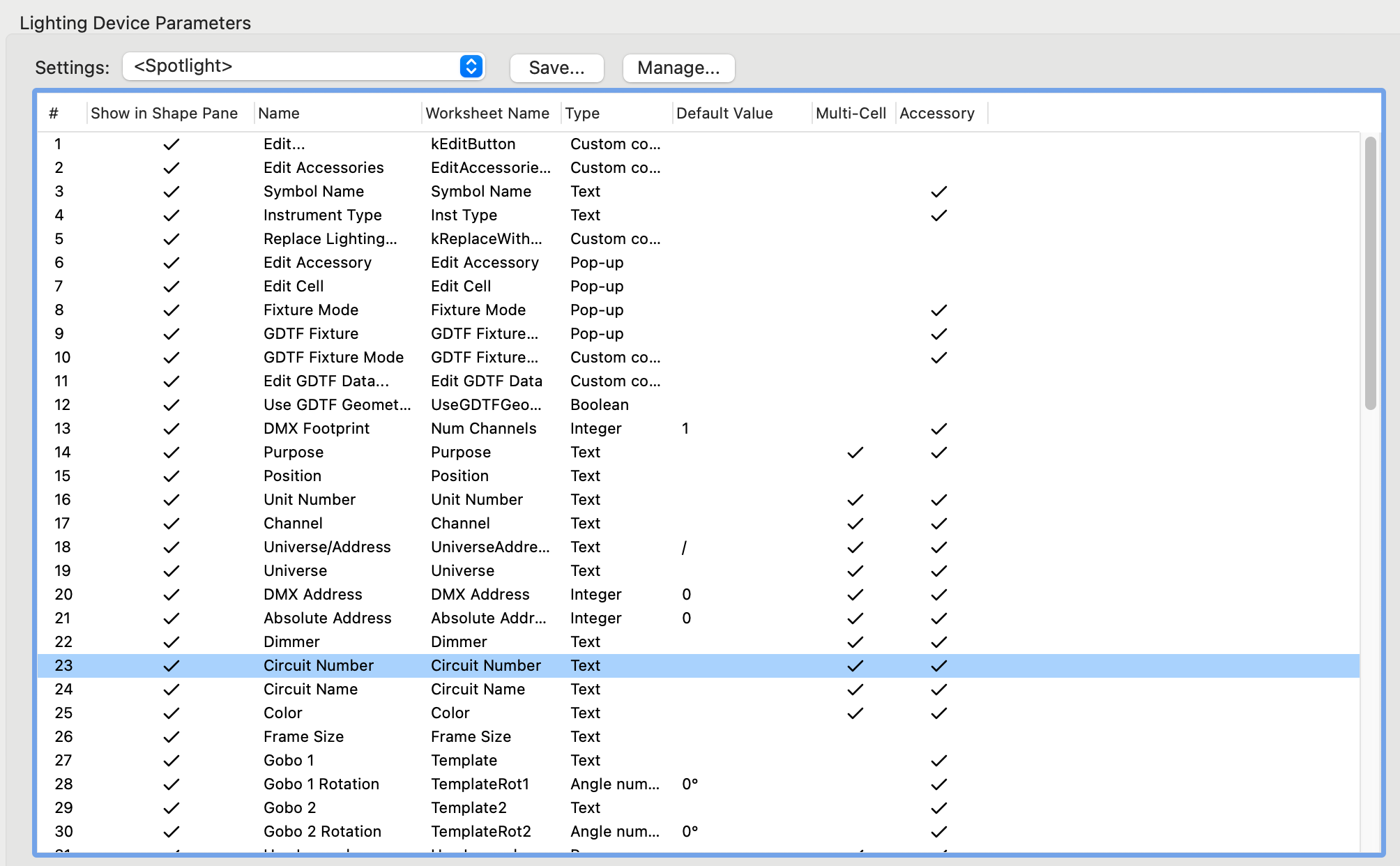

Attached a screenshot of the Spotlight Preferences (Parameters) and of a Viewport with Lighting Devices, that have a Data Visualization associated, based on the Circuit Number.
As you can see in the Legend, the order is now alpha-numeric.

Weight and Wattage are not native units in Vectorworks so they have to be text fields in order to allow the device to have a unit mark.
For many of the fields users do not use exclusively a number. For your example of Circuit Number, many users will circuit numbers such as C5 to designate it as circuit 5 in the C multi-cable and use the circuit name field for the distributor name etc.

I am familiar with the formulas in Worksheets to get around this problem, but that does not solve, for instance, the order in which the possibilities show up in a Data Visualization Legend.
Wouldn't it make a lot more sense to enable the user to change the "type" of the parameter in the Spotlight Preferences?
