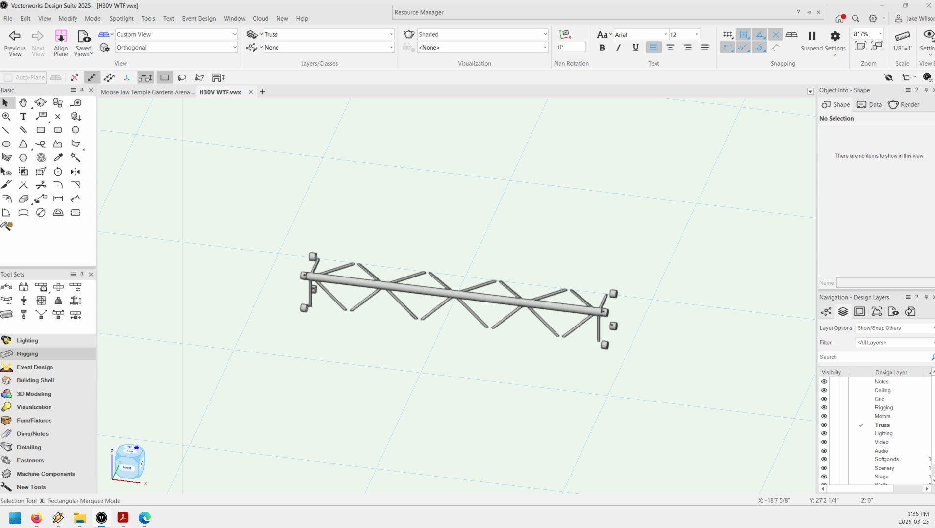

I have noticed a new strange issue with the truss tool when I try to add a VW library symbol for Prolyte H30V that I have been using for years. The truss looks fine in 2D, however in 3D it now only shows parts of the truss. I had my coworker try creating his own stick also using the truss tool and he had the same issue.
I attached the VW file and a snip of what I'm seeing just in case you don't see the same thing.
My design suite is all up to date and I tried refreshing the library but no change. I closed the file and reopened and still the same.
Any ideas?
H30V WTF.vwx

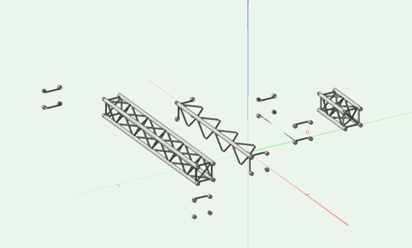

It gets weirder - if you change the Quality of Shaded view, they show up in all quality settings EXCEPT high which is where your file is saved.  Shows up in all other render modes too, so something is weird there.  Sorry I don't have an answer for you.  Best to submit this to tech support so they can take a look.
