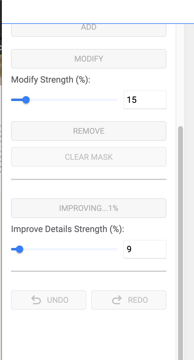

Flair-Studio Posted March 25 Share Posted March 25 Hi Dave, Thanks for coming back! My process is quite basic, when I need to explore options with the AI, I usually copy paste the base images in a new file, then I select them one by one and open the AI with the image selected. With the new interface, under composition, I need to go to refresh in order to use one image which is already in VW. Well I had experienced some issues in refreshing the image. The introduction of the edit portion of the new AI is a great and long expected one, finally once there is a lucky strike with the generation portion it is possible to refine the outcome a bit. It would be great to be able to undo part of the painting without having to erase the hole mask, like a negative brush... I also wanted to ask, in the edit section of the new AI, what is the difference between the Add and the Modify buttons? It seems like they are doing the same funcion once you have painted a portion of the image? Thanks again and don't get me wrong, the new AI is definitely a great improvement, and it would be also great to see a new coffee break on the new AI coming up soon Quote Link to comment
Vectorworks, Inc Employee Dave Donley Posted March 25 Author Vectorworks, Inc Employee Share Posted March 25 Thanks for the additional info! The refresh will use selected bitmap object or selected rendered viewport, or will make a screenshot of the whole Vectorworks window if a bitmap or viewport aren't selected. The Remove button removes areas that you have masked, is that different than the negative brush you mention? The add does a strong add, replacing what is under the mask. Modify considers what is in the masked area and depending on strength value will modify it strongly or weekly. A weak modify would tweak a few details without changing the basic region. A strong modify approaches what an Add does. Modify can be used for example to modify the color of a window without changing the frame shape. HTH 1 Quote Link to comment
Flair-Studio Posted March 26 Share Posted March 26 Negative brush is a nice to have, to have the ability to refine a complex mask Sometimes it takes forever to use the improving details section: am I doing anything wrong? Quote Link to comment
Vectorworks, Inc Employee Dave Donley Posted March 27 Author Vectorworks, Inc Employee Share Posted March 27 @Flair-Studio Improve details takes a few moments to get going, shouldn't take much more than a minute total. Quote Link to comment
