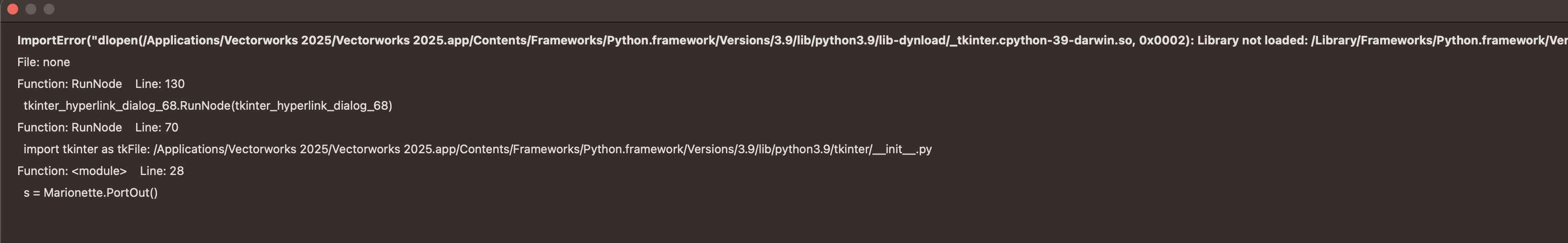

Tom M. Posted March 20 Author Share Posted March 20 Hello Marissa, Thank you very much for your support. I may not understand what you are describing in the last sentence. When I run the marionette, I receive the following error message. Quote Link to comment
Marionette Maven Marissa Farrell Posted March 20 Marionette Maven Share Posted March 20 My last sentence was just referring to the dialog not being one that Vectorworks creates, it would be a different dialog. On windows it looks like this: I'll have to test the node on Mac, I'm guessing the error you ran into is because tKinter isn't preloaded with Python on Mac; I'll see if there's a way around it. Quote Link to comment
