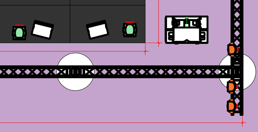

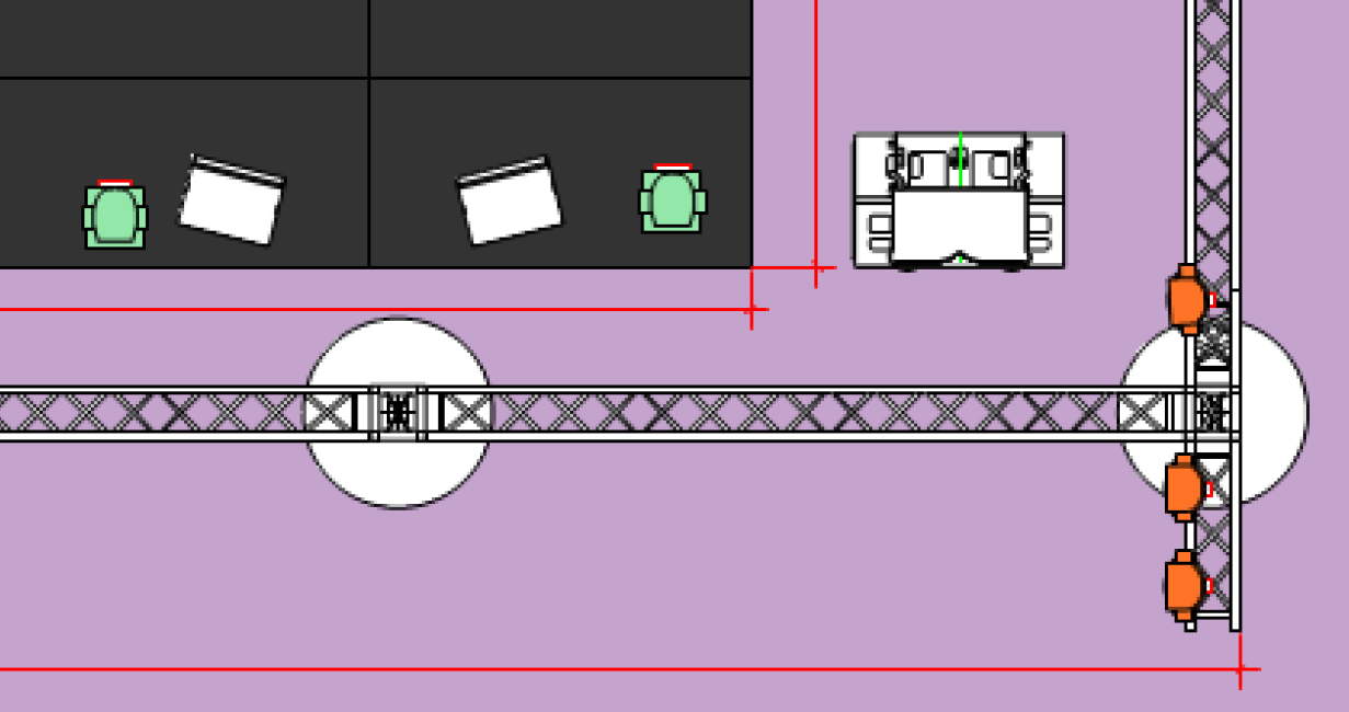

Yeah, I already tried to adjust. the first image below is from the exported PDF File. The Second Image is from the shared documents in the cloud.
From the exported rasterize pdf file.
From shared documents in the cloud.
