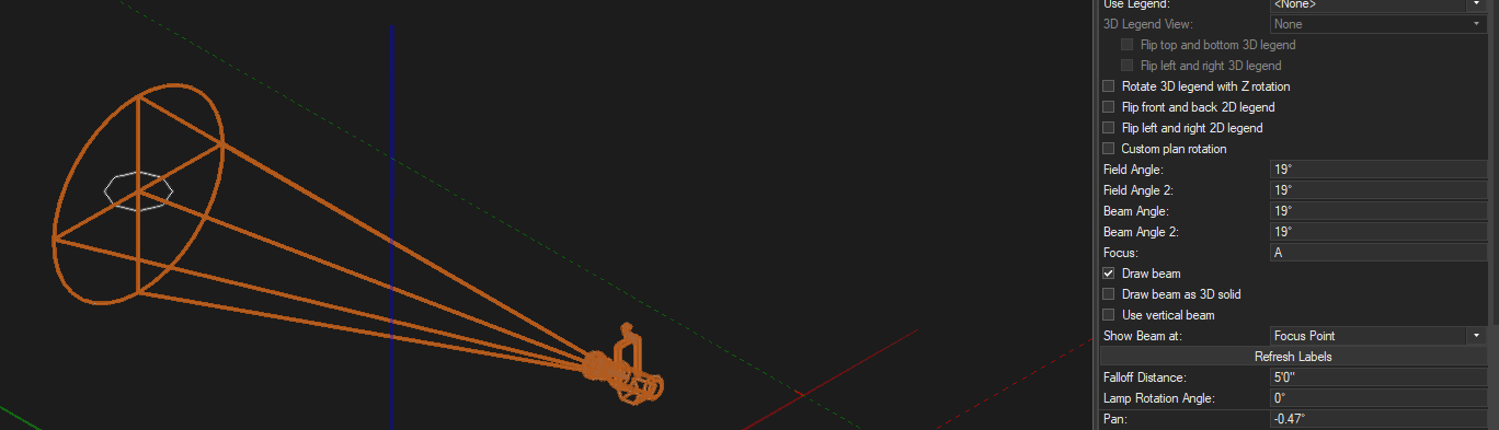

I'm having a new issue.
I'm trying to do some rendering, and I go to focus some lights, simple ETC Lustr2.
This should be easy stuff.
Lights inserted, drop a focus, turn on light, draw beam.
Nope
The focus is a vertical draw beam even though "use vertical beam" is unchecked.
I tried checking, unchecking
Replace light
all kinds of fun stuff.
So I started a blank drawing.
Dropped in a single fixture, and a focus point, turned on draw beam, and slap.
Vertical beam.
I have another drawing that is older, a save as from 2024 actually, that does not behave this way.
Is there some setting somewhere that forces fixtures to use vertical beams?
I've never seen it.
See attached.
There's a vwx25 file, and I added a screen shot in case the file opens and behaves normally for you.
lame lights.vwx

  • Vectorworks, Inc Employee
In this example the beam is drawn vertically automatically because if drawn horizontally the edge of the beam would go to infinity, or almost infinity within a reasonable distance.
In this case we automatically draw the beam vertically.
