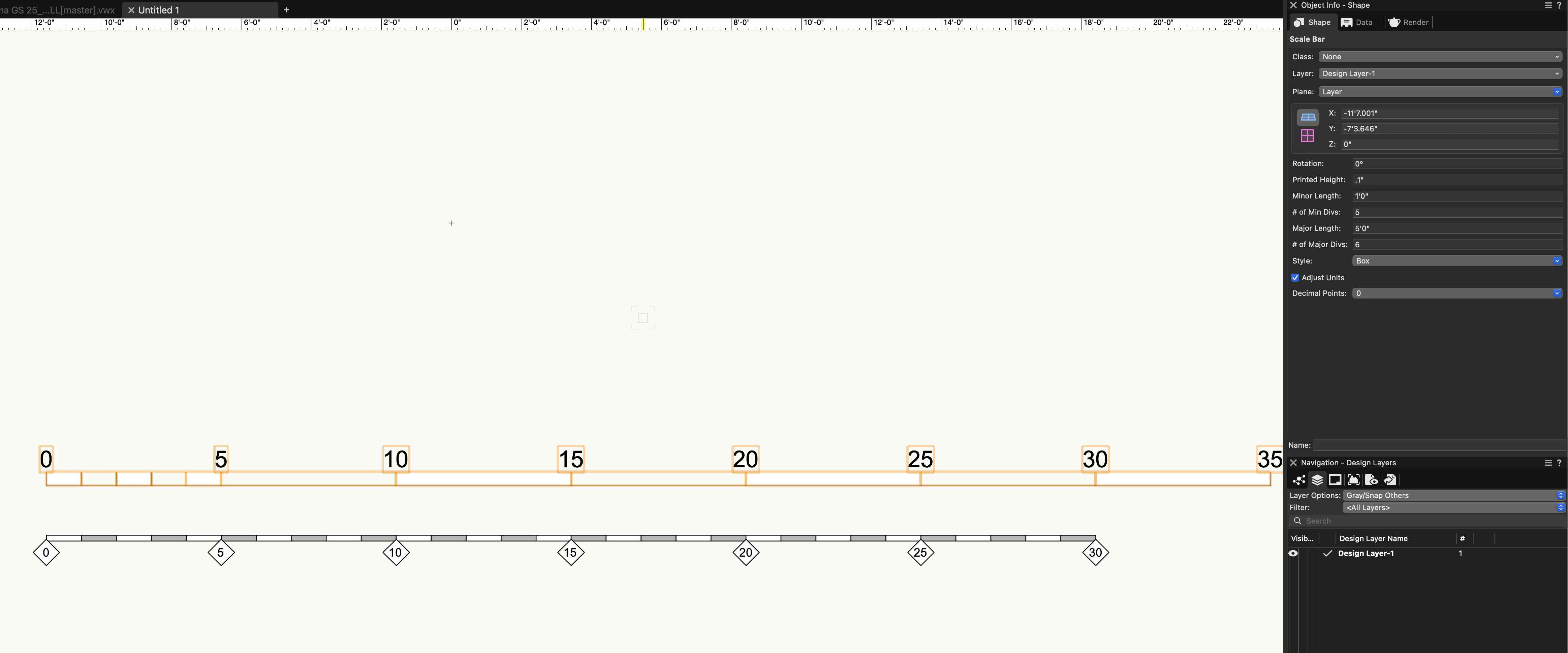

Hello! I am striving to re-create the drawing scale ruler created by Steve Shelly in his Soft Symbols, but have it be interactive. The closest I have gotten is the Scale Bar Tool, but it doesn't quite cut it.
A) the minor lengths don't continue all the way
B) I can't alternate colors in the boxes
C) I can't enclose the text of the dimension.
Does anyone have a brilliant idea (see screenshot attached)

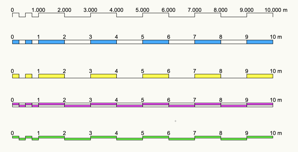

Hello,
A1: Correct only does it for the first major length.
A2. You can alternate the colours.
A3: Correct unless you have a special font that draws boxes around letters.
Below is a screenshot of some variations that the scale bar can give you.
Check the Help for more info. File enclosed.
Scale bar examples.vwx
