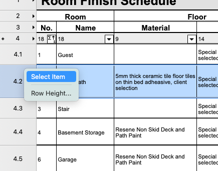

@Jonathan Pickup is correct. Currently the best option to access, edit and assign room finishes from worksheets is to select the row, right-click, and choose 'Select Item.' Then click the 'Assign Room Finishes' button on the OIP to access the entire space object at once.
This is the direct result of going to a multiple room finish solution with the existing worksheet resource. If you want to use a 2024-style schedule instead of the 2025 ones, you will only have access to a single finish per surface, but it will work as it did in 2024.

Vectorworks 2025 does not have the capability to display a popup menu for multiple finishes. This is a limitation in the workspace interface and why a right-click to navigate to the space object is now the suggested workflow.
If you are finding that importing a 2024 file into 2025 is breaking the prior worksheets, please feel free to post the file here (or send it to me via DM) so it can be looked at as a possible bug. I tested in 2024 to 2025 this morning and found no change in the behavior in the 2024 Room Finish Schedule version. It should be displaying the popup list, but will limit you to only displaying one finish for the space.
