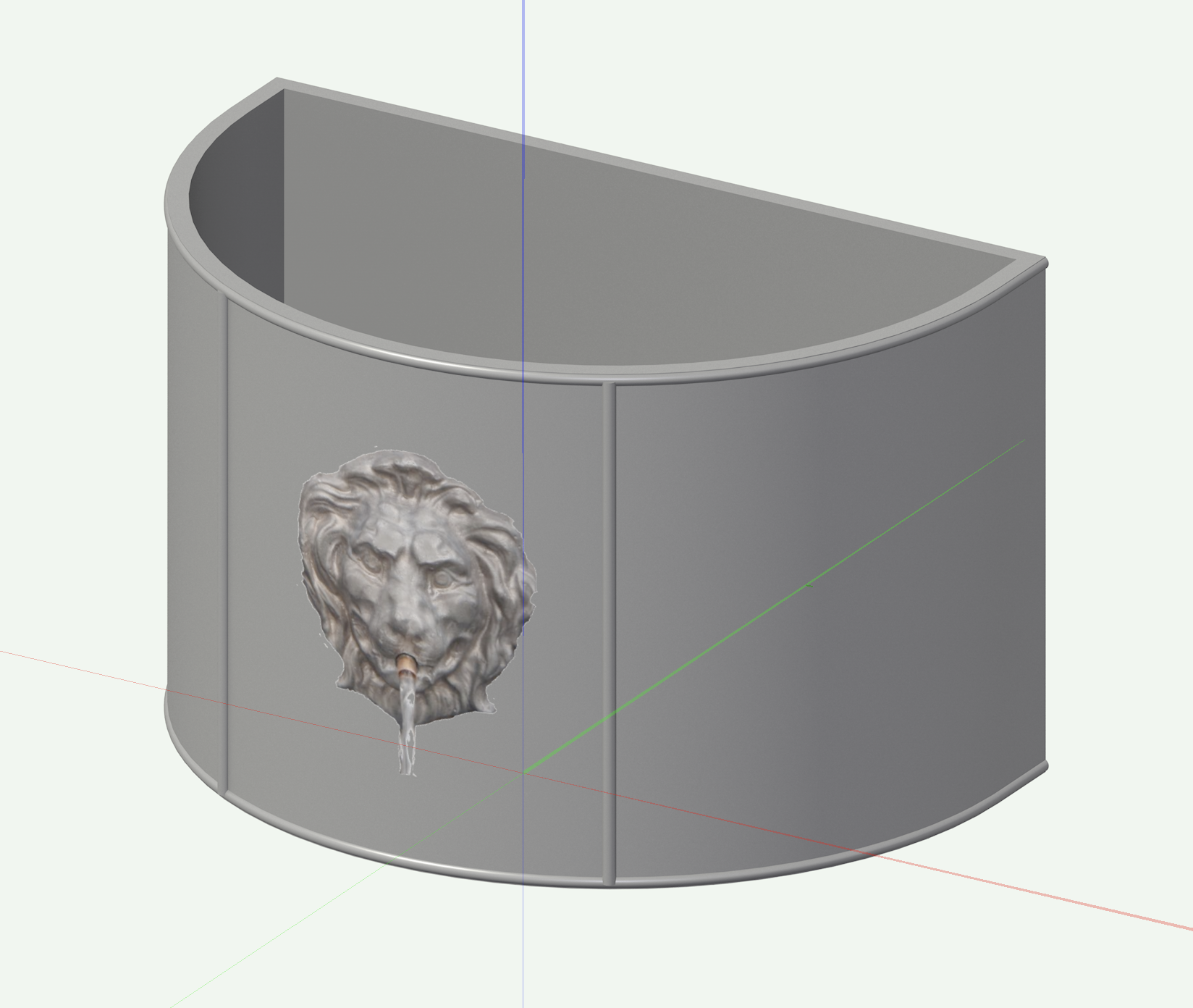

Claes Lundstrom Posted March 8, 2025 Share Posted March 8, 2025 .... or making a little more 3D 😉 fountain base2.vwx 2 Quote Link to comment

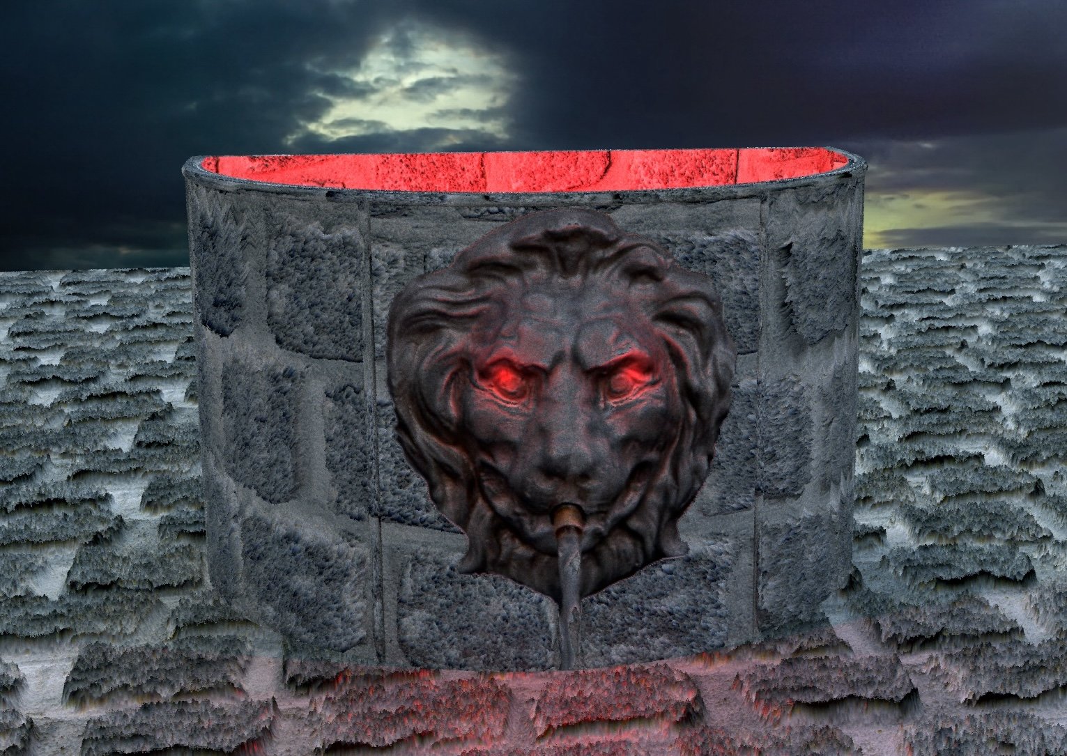

VIRTUALENVIRONS Posted March 9, 2025 Share Posted March 9, 2025 .....or demonic. Although my reacquaintance to VW rendering/animation has been quite enlightening, not so much the decal process. I did not find that intuitive. As usual trial and error works. Quote Link to comment

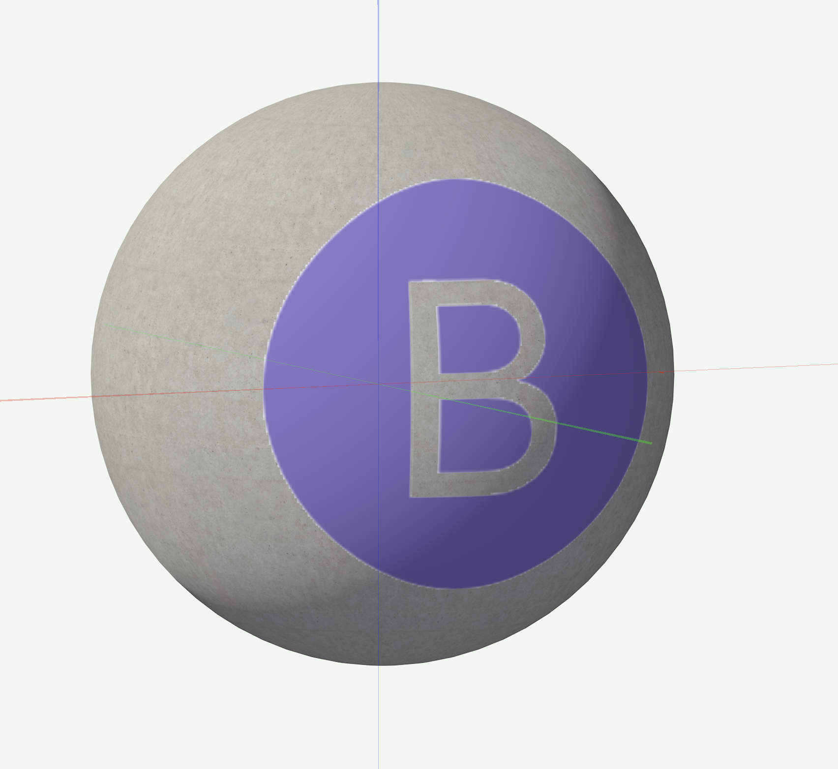

VIRTUALENVIRONS Posted March 9, 2025 Share Posted March 9, 2025 (edited) Yes, I guess we all forgot about that. Although I only figured this out this morning, here is my file. Hope it helps. I am not the best resource on this. It is not the demonic version, but you can have that one if you want. FORUM DECAL.vwx Edited March 9, 2025 by VIRTUALENVIRONS Quote Link to comment
