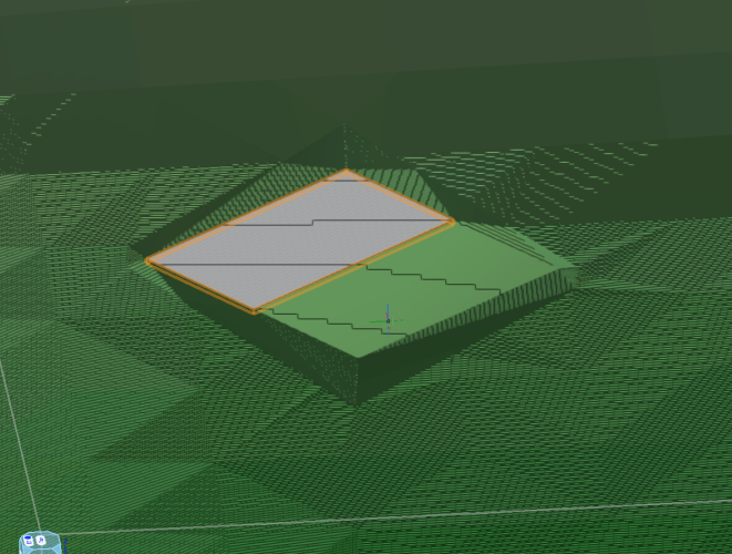

Is this normal
Question
2 answers to this question
  • 0
Check for far out objects. If you have any geometry more than 5km from the Internal Origin (blue cross hairs) you will get this kind if thing. There is good knowledge base article on far out objects if you search forum for it.
  • Like 2
Link to comment
  • 0
You are a genius, thank you. I had some stray, invisible data from the survey I used. Which I deleted, without any noticeable effect on the plan or model.
