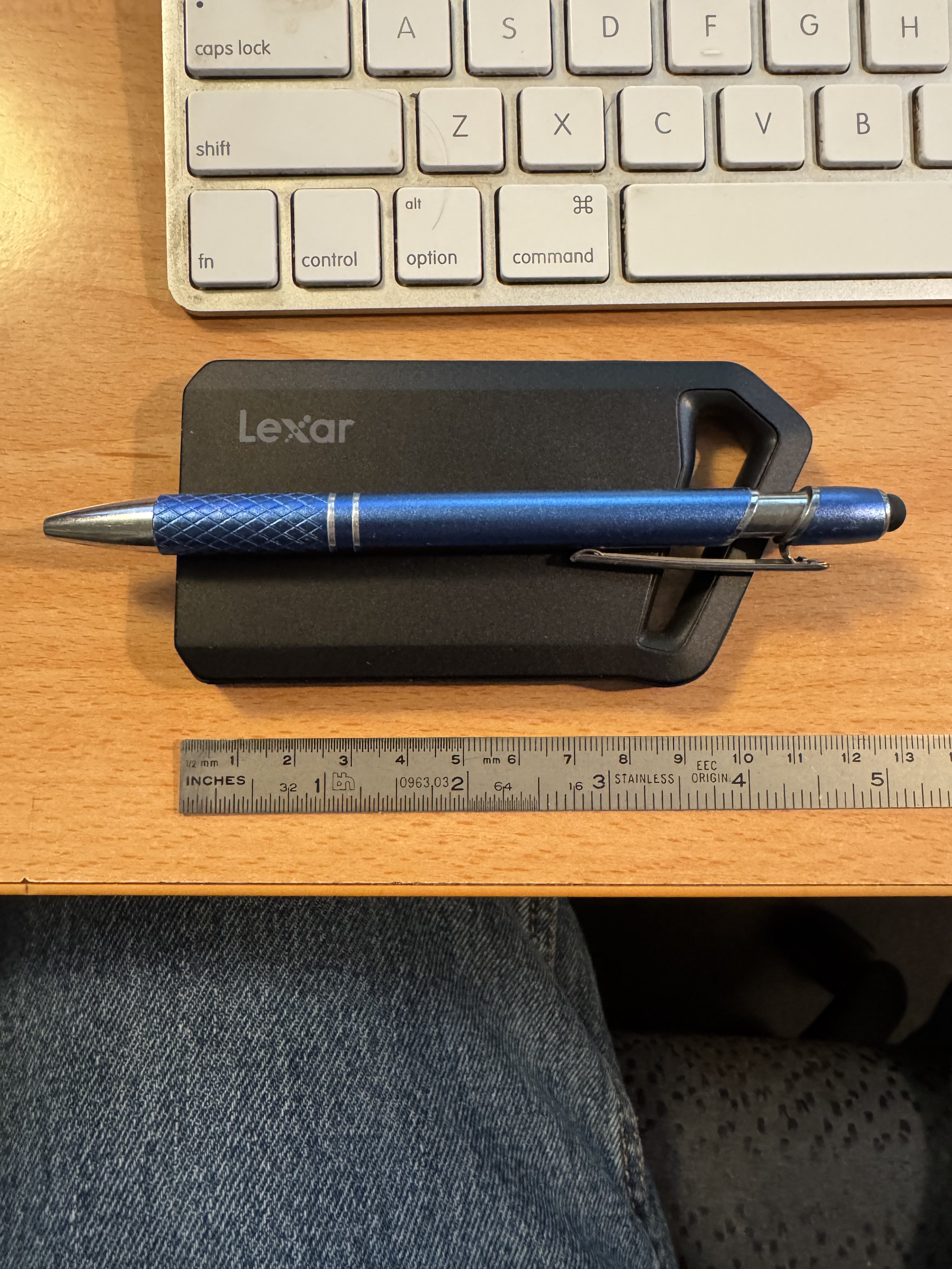

Pat Stanford Posted March 7 Share Posted March 7 15 minutes ago, rDesign said: So are external SSD drives like this one fast enough to use for storing all of your Vw files that you're actively working on? Thx Be really careful when buying external drives. I got one a few weeks about that I think was T3, but offered 2000MB/s transfer speed. Other similar drives has transfer speeds as low as 150 MB/s. Even though they said they had the same T3 connection. 4GB for about $299 at Staples. But also check the shelf tag. It said the $299. Computer tried to ring it up at $450. A week later the shelf tag still said $299. Current Staples prices $236 for 2TB, $410 for 4TB, Lexar LS600. USB 3.2 Gen2x2 2000MB/s Read / 2000MB/s write. And it is tiny. I don't think the box said Mac, but it was easy to reformat using Disk Utility and has worked great. Cloned about 2GB off my 4GB internal drive in about 45 minutes. And it is tiny. To make Mark feel less about about losing things it just took me 10 minutes to find on my desk because it is so little and under so many things. 2 Quote Link to comment

Mark Aceto Posted March 8 Share Posted March 8 5 hours ago, Pat Stanford said: Lexar LS600. USB 3.2 Gen2x2 2000MB/s Read / 2000MB/s write. Wanna trade? 1 Quote Link to comment

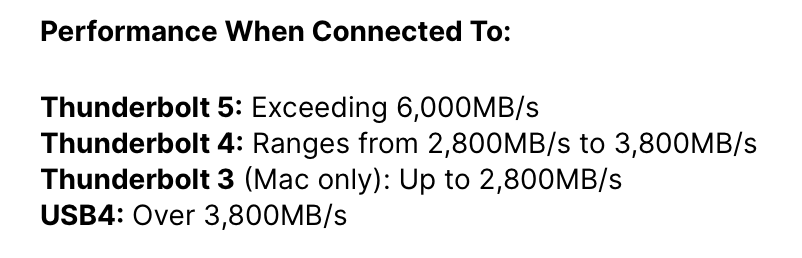

Tom W. Posted March 8 Author Share Posted March 8 16 hours ago, Pat Stanford said: Be really careful when buying external drives. I got one a few weeks about that I think was T3, but offered 2000MB/s transfer speed. Other similar drives has transfer speeds as low as 150 MB/s. Even though they said they had the same T3 connection. OWC Envoy Ultra Thunderbolt 5 SSD: 1 1 Quote Link to comment
Mark Aceto Posted March 8 Share Posted March 8 3 hours ago, Tom W. said: OWC Envoy Ultra Thunderbolt 5 SSD: 60gb/s is impressive this is a nice little summary of what to expect from each confusing cable gen (assuming the drive read / write speed can keep up with the cable bandwidth): 2 Quote Link to comment
Tom W. Posted March 8 Author Share Posted March 8 10 minutes ago, Mark Aceto said: 60gb/s is impressive this is a nice little summary of what to expect from each confusing cable gen (assuming the drive read / write speed can keep up with the cable bandwidth): 6GB/sec no...? So yes, as you said earlier quite a dramatic reduction on the capacity of the cable/interface! BTW why is it 80 or 120GB/sec for TB5? Quote Link to comment
Mark Aceto Posted March 8 Share Posted March 8 58 minutes ago, Tom W. said: 6GB/sec no...? ha i added a zero... yeah this is the thing to look for: 2 Quote Link to comment

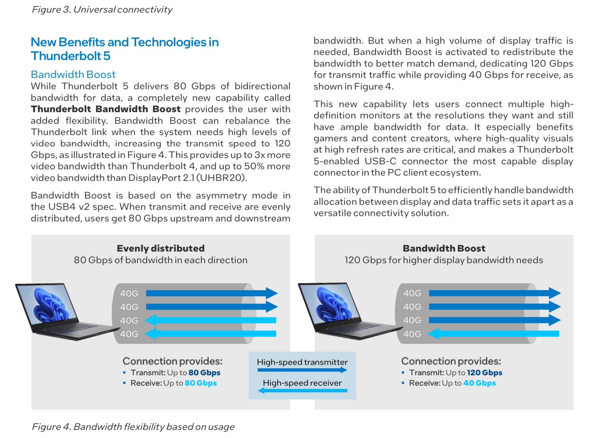

Tom W. Posted March 9 Author Share Posted March 9 On 3/7/2025 at 6:35 PM, Mark Aceto said: The M3 Ultra build is the Studio everyone expected last summer, and is the best all-rounder (albeit with 2024 components at 2025 pricing). The only caveat of this build is single core clock speed (unless you count some perceived hardware accelerated ray tracing on a weak GPU). So would an 80-core GPU on an M3 Ultra offer any benefits over a 32-core GPU on an M4 Max as far as Vectorworks is concerned? Quote Link to comment
rDesign Posted March 9 Share Posted March 9 22 hours ago, Tom W. said: BTW why is it 80 or 120GB/sec for TB5? Copied from this Thunderbolt 5 Technology Brief PDF: 1 1 Quote Link to comment
