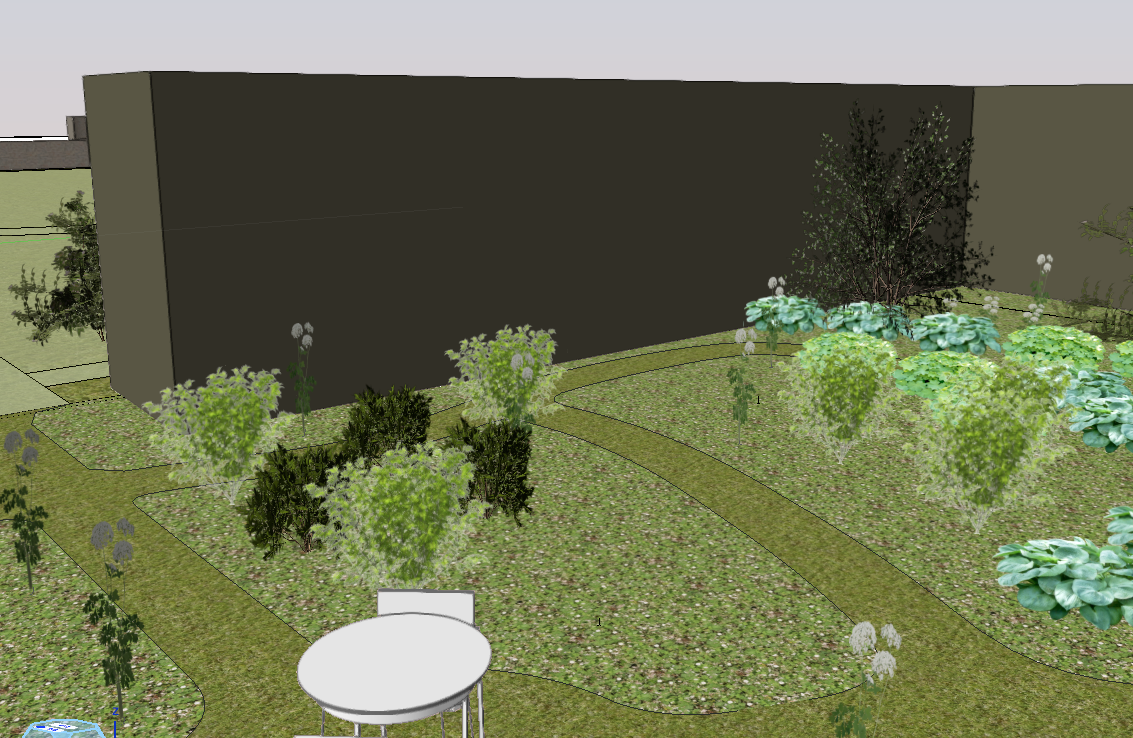

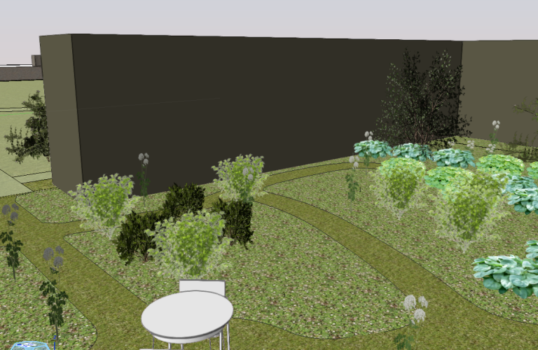

Jack Wallington Posted March 4 Share Posted March 4 Hello, I was wondering if there is a way of giving a Hedgeline a 3D texture? To make it appear fluffier and less blocky. I have tried adding an image to hedges in the model I'm working on, but for some reason they go completely transparent (I've attached screen grabs showing this), which I haven't worked out yet. But perhaps there is a better 3D texture I can use? Quote Link to comment

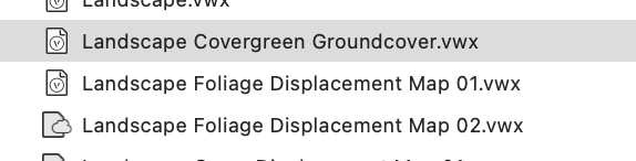

Tom W. Posted March 4 Share Posted March 4 @Jack Wallington have a look at these textures in Visualisation > Renderworks Textures in the VW Libraries: One of the weird + not particularly great things about Hedgerows is that if you give them a Gradient in 2D they lose their texture + display as wireframe in 3D... Solid Fill or Hatch Fill are fine, just not a Gradient Fill. 2 Quote Link to comment
Jack Wallington Posted March 4 Author Share Posted March 4 1 hour ago, Mike Lamb said: Hi Jack, if you select the hedge and go to the render tab in the object info palette, you can assign it a texture there. Hope this helps. Mike 47 minutes ago, Tom W. said: @Jack Wallington have a look at these textures in Visualisation > Renderworks Textures in the VW Libraries: One of the weird + not particularly great things about Hedgerows is that if you give them a Gradient in 2D they lose their texture + display as wireframe in 3D... Solid Fill or Hatch Fill are fine, just not a Gradient Fill. Ah, brilliant, thank you so much Mike and Tom. And thanks for the tip about the gradient Tom. Quote Link to comment

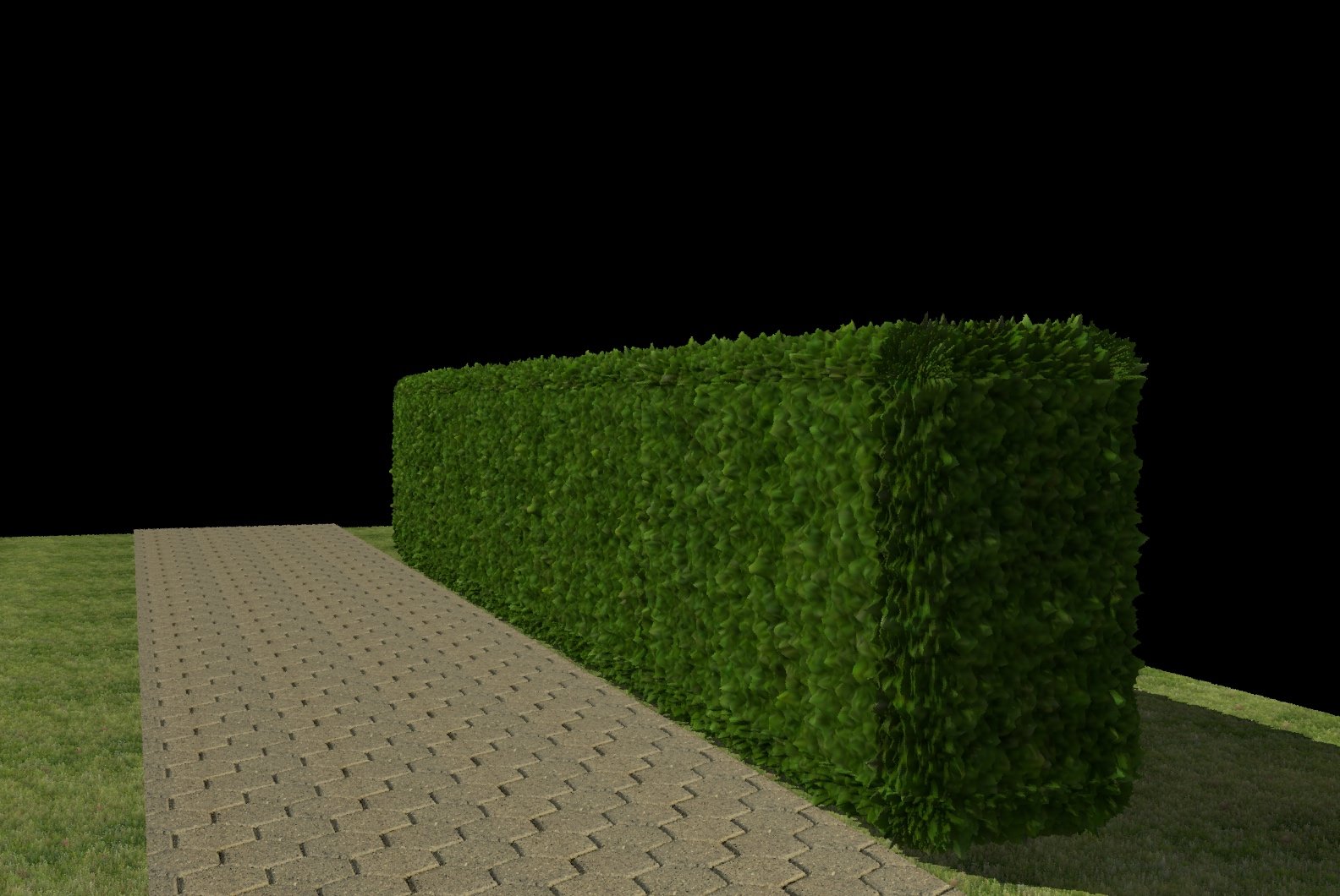

VIRTUALENVIRONS Posted March 4 Share Posted March 4 I have been playing with Vectorworks textures recently. Is this something you are thinking of. 1 1 Quote Link to comment
Amanda McDermott Posted March 4 Share Posted March 4 37 minutes ago, VIRTUALENVIRONS said: I have been playing with Vectorworks textures recently. Is this something you are thinking of. What settings did you use to get this please @VIRTUALENVIRONS? Quote Link to comment
Jack Wallington Posted March 4 Author Share Posted March 4 1 hour ago, VIRTUALENVIRONS said: I have been playing with Vectorworks textures recently. Is this something you are thinking of. Wow yes, that would be great! Look fab, well done. Quote Link to comment
VIRTUALENVIRONS Posted March 4 Share Posted March 4 @Jack Wallington@Amanda McDermott My apologies for the late response, out shopping. This is an imported image texture comprised of two textures and needs some explanation. I will post the texture and a short video later today or tomorrow. Quote Link to comment
VIRTUALENVIRONS Posted March 4 Share Posted March 4 The texture and explanation of its use. TEXTURE.vwx 3 Quote Link to comment
Tom W. Posted March 4 Share Posted March 4 The textures in two of the VW library files listed above have displacement mapping. A Hedgerow object can’t have filleted edges unfortunately which gives your object @VIRTUALENVIRONS a big advantage. Quote Link to comment

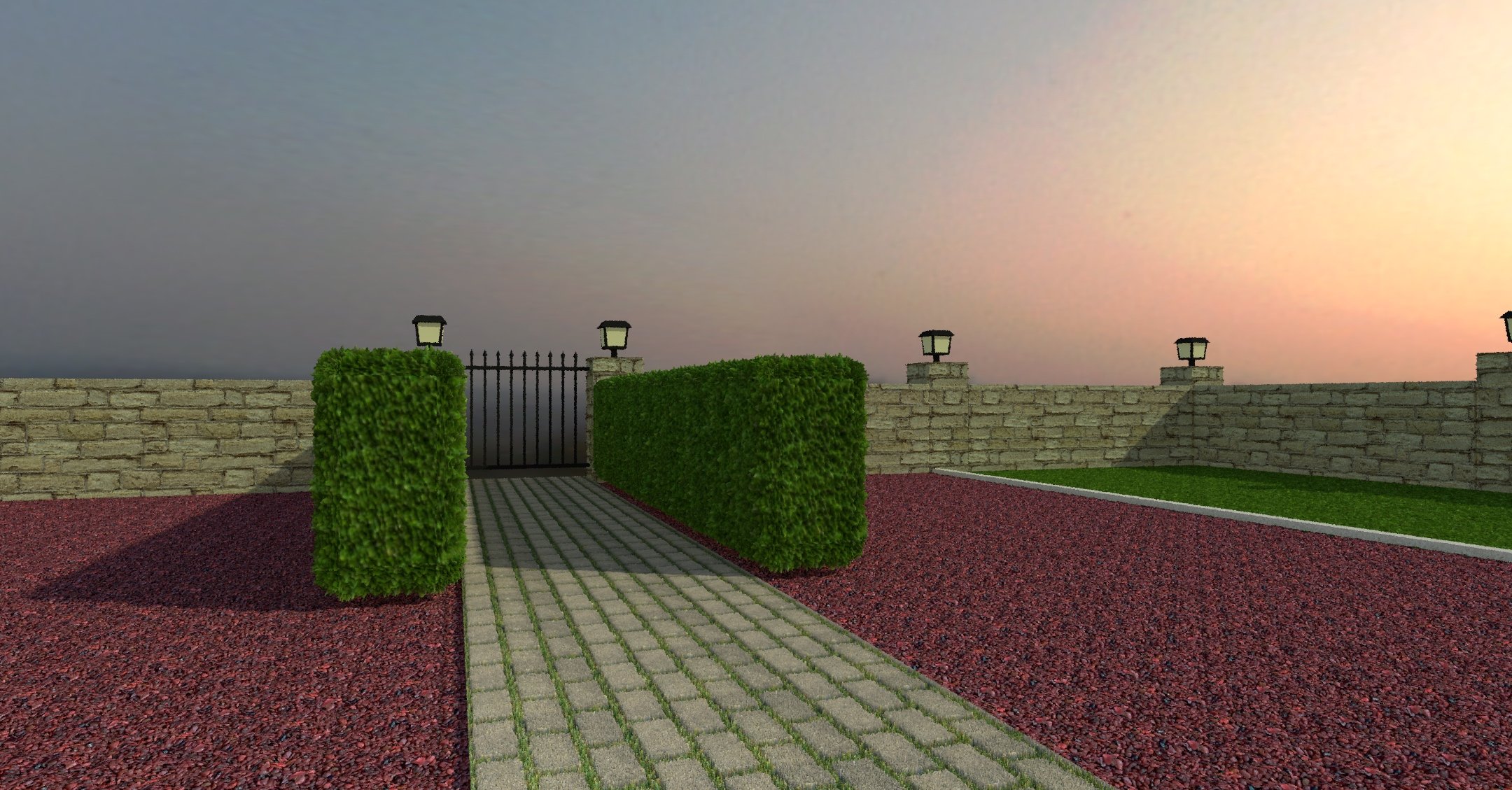

VIRTUALENVIRONS Posted March 5 Share Posted March 5 Been playin' a bit with displacement mapping in Vectorworks. 1 Quote Link to comment
