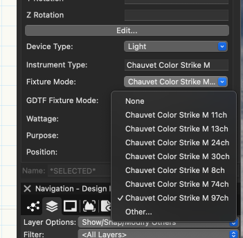

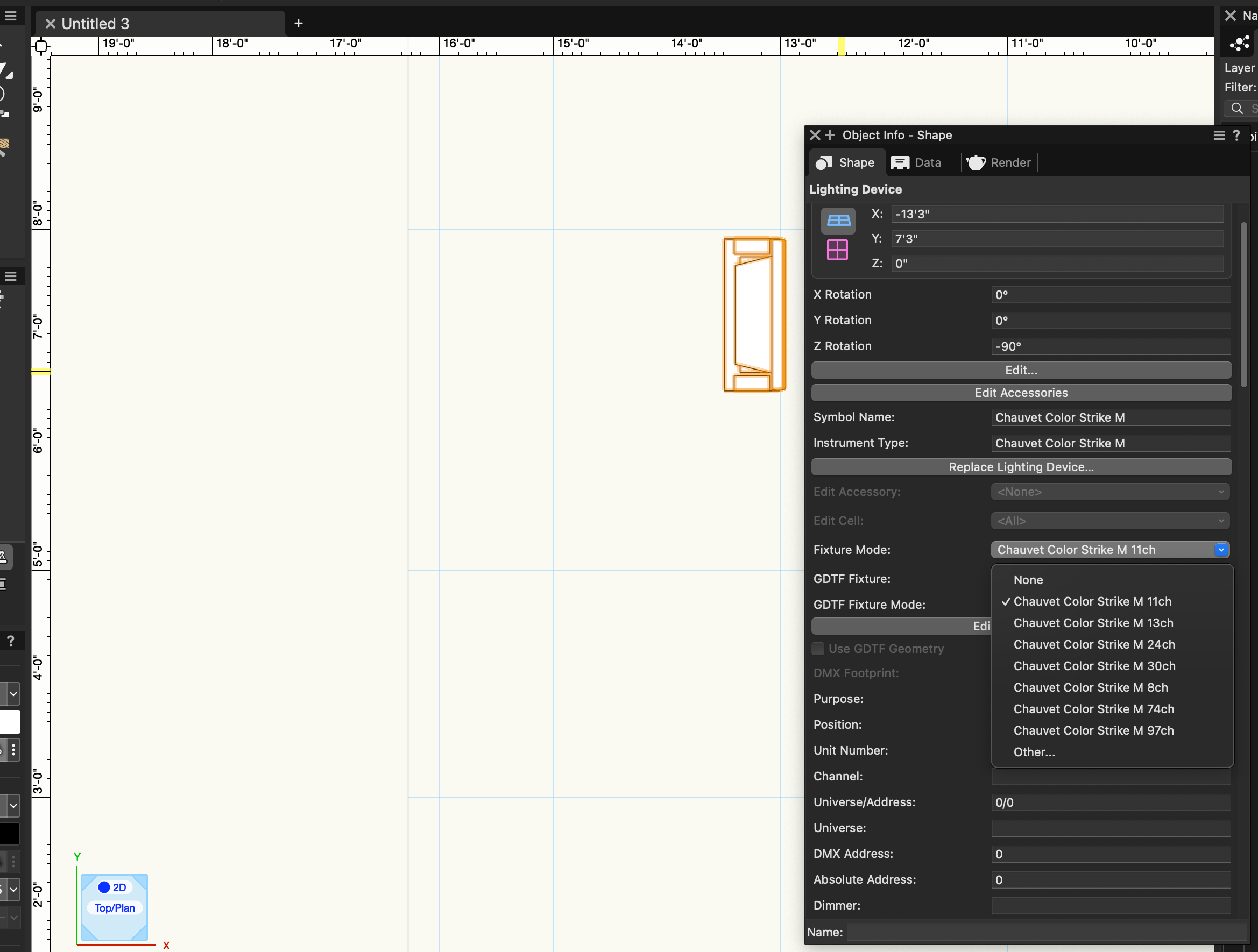

sbarnett Posted March 4 Author Share Posted March 4 1 hour ago, JustinVanHassel said: I just updated my Vision libraries and the 68 channel mode is available. Thank you for your reply. I am confused now.... I have checked this file on another device my Desktop PC when I got home. I open the file and it does reflect the fixture with the 68 mode. I did not have to refresh the library on the PC to have the correct modes listed. feeling stupid I went back to my MacBook Pro and updated the libraries with refresh in the drop down. I replaced the fixtures in the file with the symbol from the refreshed resource manager and still no 68mode. I then open a new empty file insert the symbol from the vectorworks lib and I get no 68 mode. I can open this new file created on the Mac that shows no 68 mode and when on PC it has the mode. what would cause the same file to display different modes on PC v Mac if symbol is saved in file? If it is an old symbol or a wrong version, should I not get the same result on either platform? Both PC and Mac are v3.1 2025 I refreshed the resource mgr only on the Mac and I get the same result after update. The refresh command on the mac did not give any indication the it failed or did not update. Is there another step I am missing in this loop? Quote Link to comment
Vectorworks, Inc Employee klinzey Posted March 4 Vectorworks, Inc Employee Share Posted March 4 The available fixture modes are not stored with the file or the symbol, they are part of the application. This data is common between Vectorworks and Vision so it's stored in a common location that can be accessed by both applications. The Vision library updater is in control of updating the information as these files are critical to the operation of Vision and updates are done between releases. The updated data you are looking for is not yet included with the default installation of Vectorworks but it is available as a library update in Vision. It looks like you have updated Vision library on Windows but not on the Mac. Quote Link to comment
sbarnett Posted March 4 Author Share Posted March 4 15 minutes ago, klinzey said: The available fixture modes are not stored with the file or the symbol, they are part of the application. This data is common between Vectorworks and Vision so it's stored in a common location that can be accessed by both applications. The Vision library updater is in control of updating the information as these files are critical to the operation of Vision and updates are done between releases. The updated data you are looking for is not yet included with the default installation of Vectorworks but it is available as a library update in Vision. It looks like you have updated Vision library on Windows but not on the Mac. This resolved the issue. I have to install a program that I am not using, to get a program I am using to function as expected. Not an intuitive workflow but I guess it's a workflow. Thanks for the quick answer. Is this documented somewhere? Quote Link to comment
