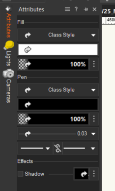

The Attributes palette takes up a lot of VW real estate, relative to its functionality.  The big bars of color and transparency waste tons of space, and do not look all that attractive either.  We need a version that can be minimized for use on laptops and smaller resolution screens.
 @cberg this appears to be another in a series of VW faux pas where an updated UI change is NOT flushed out completely.
Starting with VW 2024, the complexity of some items - Attributes as you mention also snaps   - are much more involved to use. Drawing on a laptop, I find the ability to open / close Palettes (as in ... say 2021 and before) equals an efficient uncluttered workflow. Many palettes (OIP / Attributes / Resource Manager...) are only opened via the keyboard only when needed. This equates to more visual design real estate, and when open, the palettes can be centrally located. The Attribute Palette is one I do NOT leave open.
One Workflow trick (avoiding the Attribute Palette ? ) is to use the Eyedropper tool with a few "example items" placed outside the drawing area. These "example items" could be shapes & lines with desired attributes / class settings / Styles / etcetera. One might have these "example items" in a Template or Favorite drawing that is easily opened through the Resource Manager. Copy from this Favorite drawing / Paste into the current design.
Keyboard shortcut Shift-E brings up the Eyedropper or Shift-E twice will show the Eyedropper settings.
The Eyedropper is able to extract some or all of the attributes in the "example item" and insert same into the target item.
We use this workflow for items specific to our different clients / designs. (Logo colors for instance) Makes for an easy and consistent look / feel - helps avoid the looooooong waits when selecting some VW features. Line type for example.

I agree with it taking up a lot of space! to help with this ive made it as an un-pinned (popout) pallet on the side of my screen.
What id really like to see is the ability to have it on the Smart Options Display! even if it was a slimmed down version.
