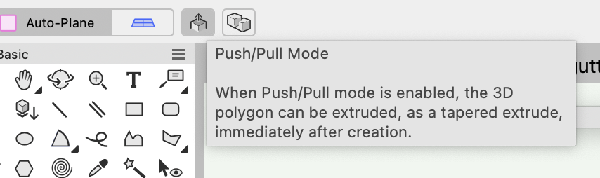

Tom W. Posted February 27 Share Posted February 27 3 hours ago, ddcpe said: pulled the face up & down 6" and got an error saying the "objects selected that were locked or are illegal in extrudes and sweeps" in both cases. tried the extrude command as well and it failed with same message in both cases. Whilst you can't run the Extrude command on a 3D Polygon you should be able to use the Push/Pull tool on it. It even has a Push/Pull Mode as part of the tool: The 3D Polygon does need to be planar though. If it is twisted, even by an imperceptible amount, it won't work. Having said that I would probably do it using 2D Polygons from the outset as already described. Quote Link to comment
