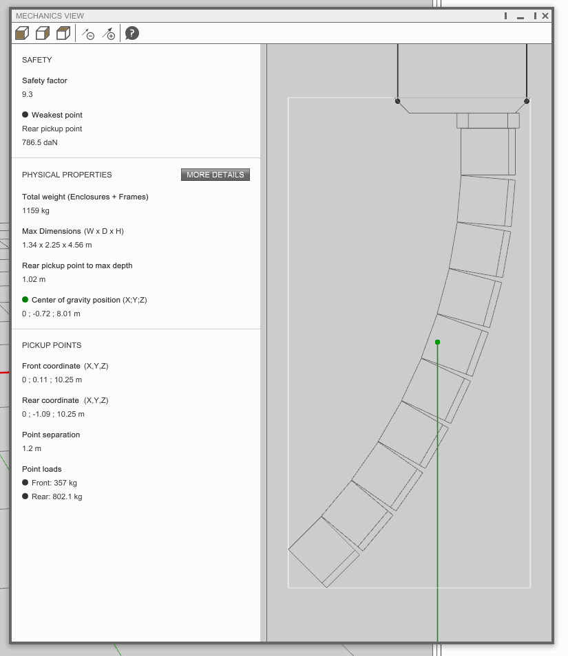

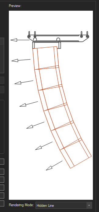

spettitt Posted February 21 Share Posted February 21 Hello, not 100% sure which forum content library errors should go in, but one for @JustinVanHassel I suspect. The K1 in the library has the wrong tilt reference - in real life, boxes remain pinned at their rear, and splay outwards from the front. From Soundvision: Quote Link to comment
Vectorworks, Inc Employee JustinVanHassel Posted February 21 Vectorworks, Inc Employee Share Posted February 21 Thank you. This was already discovered and noted. A fix has been scheduled for a future update. 2 Quote Link to comment
Vectorworks, Inc Employee JustinVanHassel Posted May 9 Vectorworks, Inc Employee Share Posted May 9 The fix for this will go into VW2026 U0 which is the launch day version. The L-Acoustics speakers and bumpers are also included in the test set of content that will go out in the VW2026 betas so there will be a chance to look at the fix there as well. Quote Link to comment
