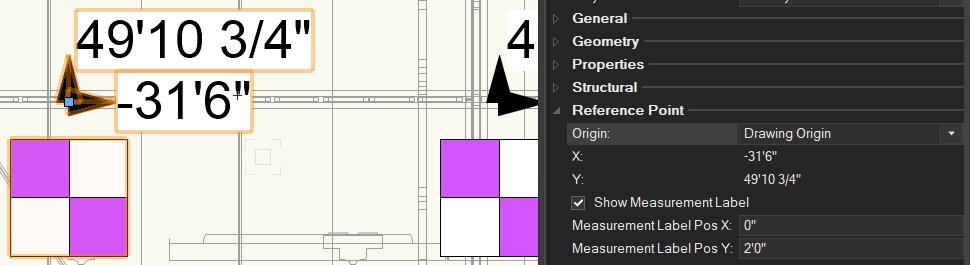

Giallovision Posted February 17 Share Posted February 17 I am trying to make a custom label for the Hoist measurement label. Is there a way to edit the originally referenced data tag such that when I click the checkmark box for "Show Measurement Label" it uses my custom label? Quote Link to comment
Vectorworks, Inc Employee klinzey Posted February 18 Vectorworks, Inc Employee Share Posted February 18 You can not modify the measurement label. This is the default label that just shows the measurement distances and not an actual data tag. Detailed and customized information can be displayed using a Data Tag. Default data tags are available in the Resource Manager, Libraries\Annotations\Data Tag (styles)\Entertainment\Hoist.vwx You can use these and/or modify them to fit your needs. 1 Quote Link to comment
