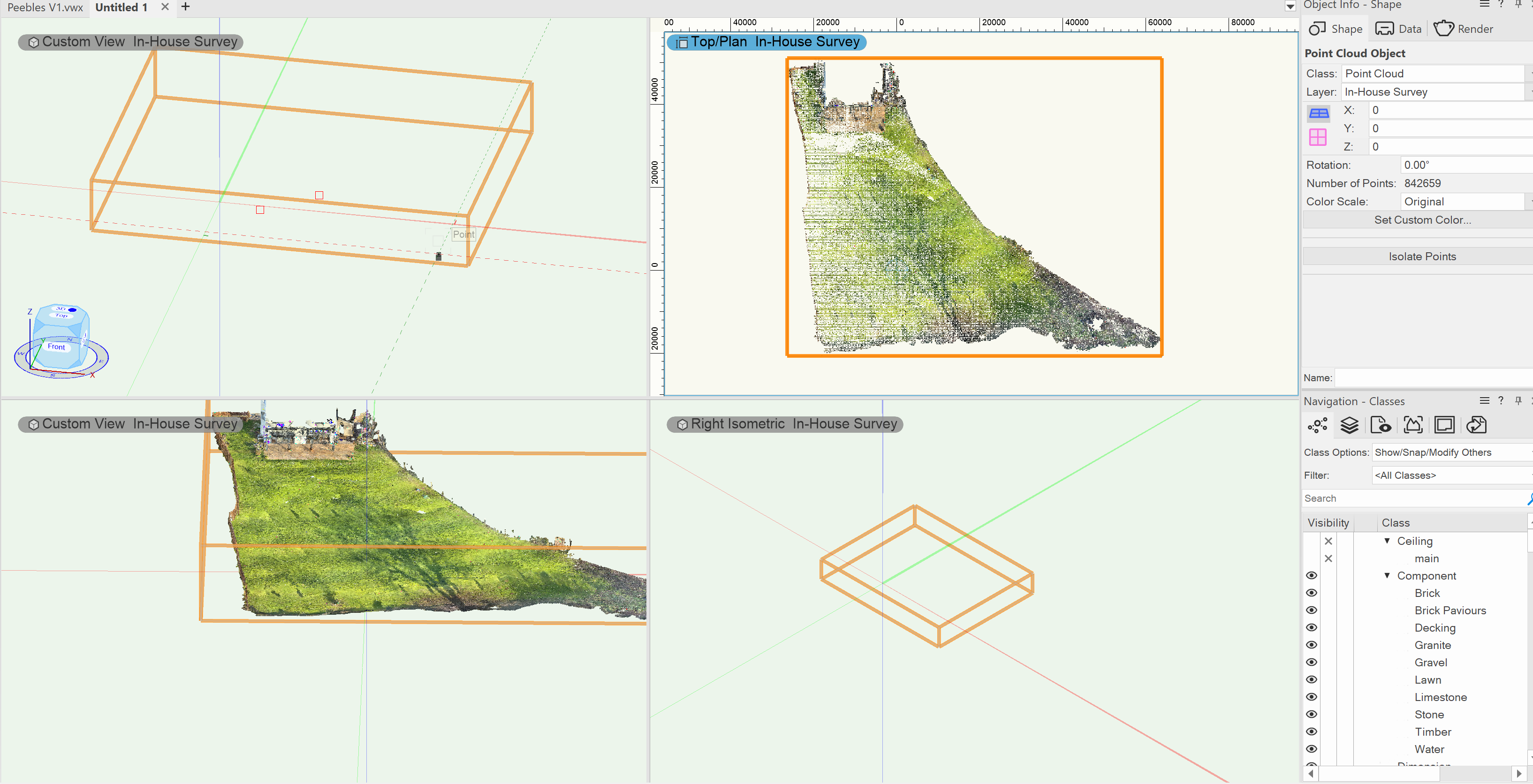

When turning on multiple view panes an existing point cloud object appears only as the bounding box in 2nd and subsequent views. The only exception is that it is viewable in Top Plan view. New objects of other types do appear correctly in each view. Possibly I am missing something obvious, but I have not seen this behaviour before. Any advice/ workarounds known?

Thank you for bringing this to our attention. I can replicate this and have filed a bug according. In my test it is only showing in one window whereas in v2024 it draws in all of them.
VB-209897
Point Cloud and Multi Views - only one window shows the Point Cloud unlike v2024
