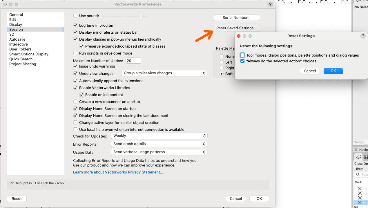

  • 0
@Pat Stanford yeah but as far as I know, that’s a setting made in MacOS, not in VectorWorks, so resetting saved settings won’t help it.
btw, deleting the VW folder and reinstalling VW doesn’t reset saved settings anyway, however it helped in that issue. Could be another proof, that that’s not a vectorworks issue but a problem inbetween VW and macOS.
however I’ll try tomorrow.
maybe you can do so as well.
if you’re right, clicking that button would cause to rechoose to allow vectorworks to „find devices on local networks“.
however I’m not convinced, that you’re right.
