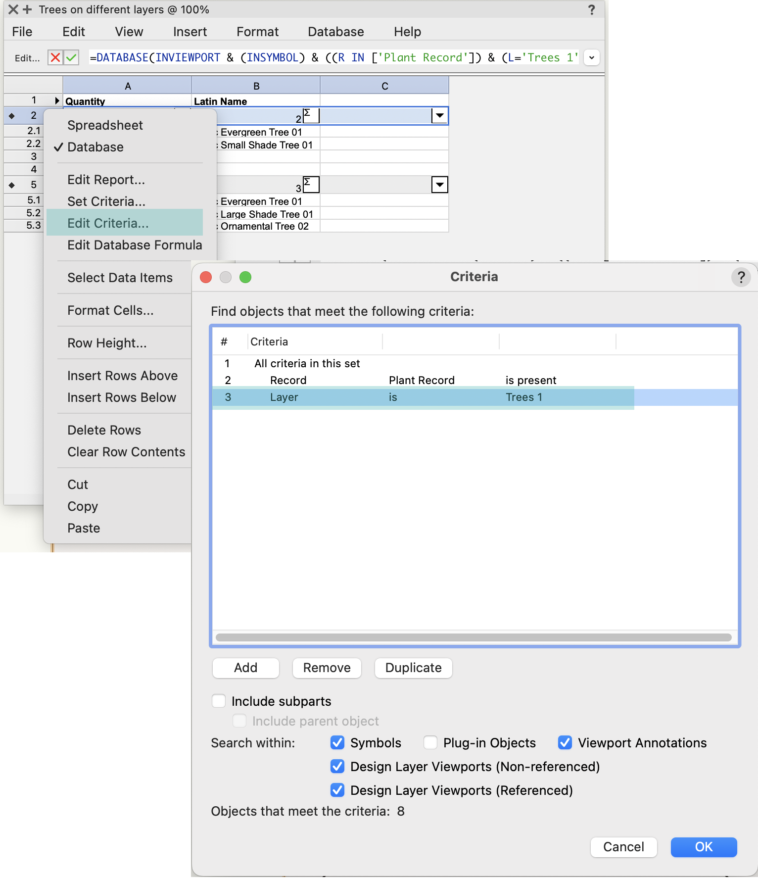

Vectorworks, Inc Employee Katarina Ollikainen Posted January 28 Vectorworks, Inc Employee Share Posted January 28 @Jack2022, the best way to deal with this is via the criteria in the worksheet. The norm is to look at the layer, but if you want to make something more specified, please weel free. Below is a sample file. It's important that it says ALL criteria in this set, not ANY. Right-click on the row number and select 'Edit Criteria' Place the trees on separate layers depending on what schedule you want them in. In the Criteria for the worksheet, select only the layers you want included in that specific schedule. Copy the database header used and paste it below if you want to create a separate schedule (in the same worksheet) for a different layer. You can, of course also use 'Layer is not' - this excludes a specific layer from the criteria. Plants on different layers.vwx 1 Quote Link to comment

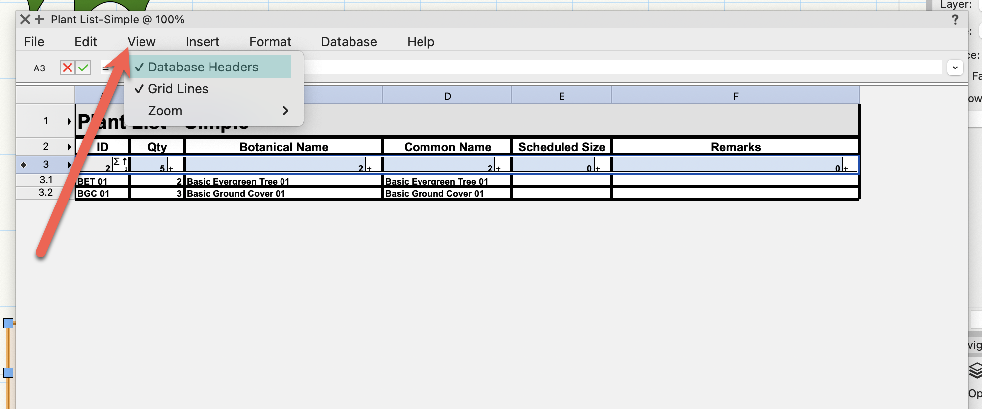

Vectorworks, Inc Employee Katarina Ollikainen Posted January 28 Vectorworks, Inc Employee Share Posted January 28 They're both worksheets. The database header can be set up to look for all objects of a specific style. Here, I have it set up to find all objects with the plant record. I can then narrow things down, sort, and sum up the found objects. If you're working with the preformatted 'Simple plant list' worksheet, this also uses the database header. If you don't see them, make sure to turn this on in the View. Quote Link to comment

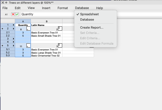

Jack2022 Posted January 29 Author Share Posted January 29 Hi Katarina, for some reason I can't change it to a Database (see attached). When I click on 'Database' in the menu it reverts to 'Spreadsheet' and therefore I don't get the option to choose criteria (greyed out). This is in your file so seems strange. Same in any sample worksheet I open from the Vectorworks resources. Quote Link to comment
Jack2022 Posted January 29 Author Share Posted January 29 Sorry - Database does work in your file but not any of the worksheets I import Quote Link to comment
Jack2022 Posted January 29 Author Share Posted January 29 Sorry again! All sorted. I missed that I had to select the column heading first! Many thanks 1 Quote Link to comment

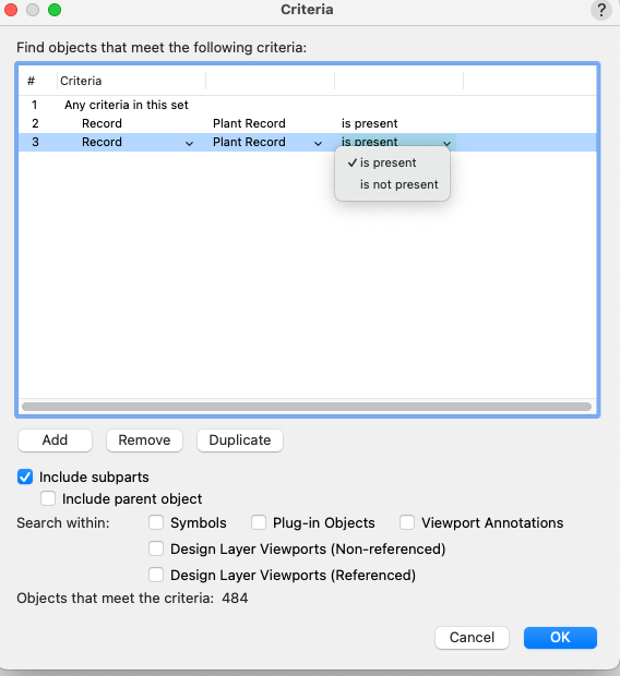

Jack2022 Posted January 29 Author Share Posted January 29 I only have the options below: Struggling to get the category to show in the Criteria menu... Quote Link to comment
Tom W. Posted January 29 Share Posted January 29 Sorry @Jack2022 you need to select Field Value > Plant Record/Category > is > Shrubs (for example) 1 Quote Link to comment
