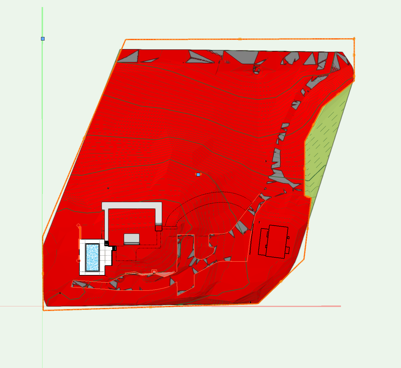

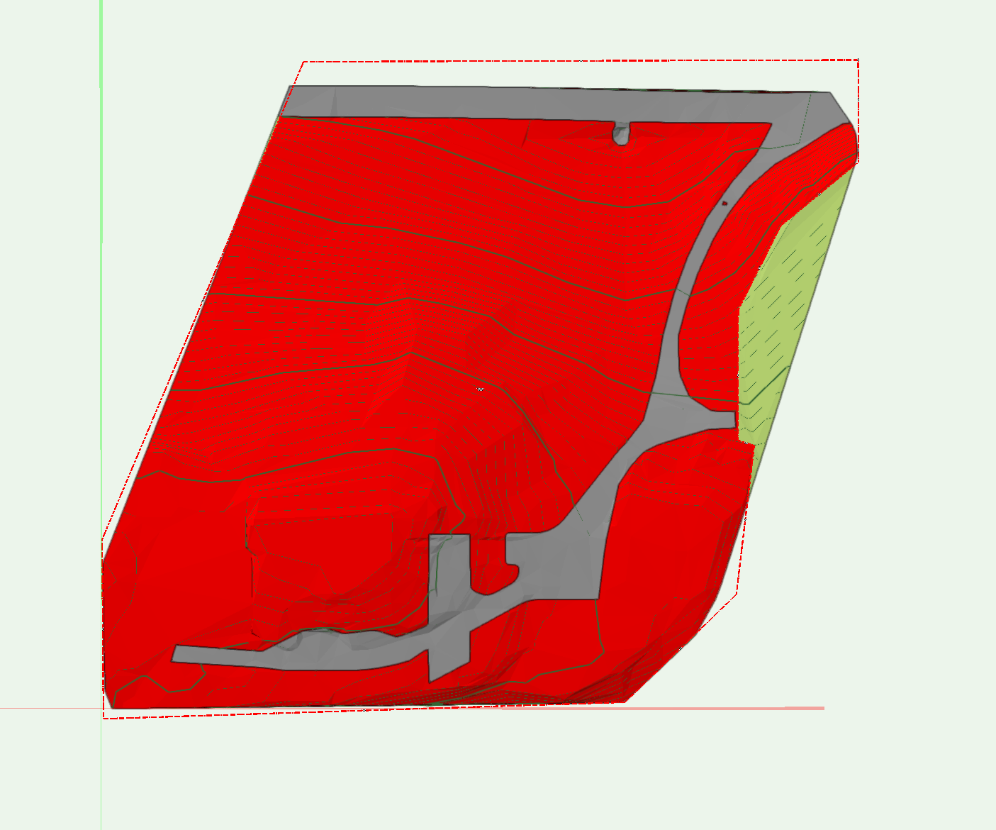

hollister design Studio Posted January 17 Share Posted January 17 This just happened... All the area of my site model inside my prop line have turned red. If I edit the shape of the prop line, the red stays inside the new prop line boundary. I have visualizations set to <none> Note - It also broke the ability for hardscapes to drape. Quote Link to comment
0 Pat Stanford Posted January 18 Share Posted January 18 What display mode are you using? It looks like that might be the 3D Mesh - Slope Display version and your don't have the various slopes set correctly for the actual slopes on site. Quote Link to comment
0 hollister design Studio Posted January 18 Author Share Posted January 18 @Pat StanfordIt is a 3D mesh. I'm not sure where to set Slope Display - it is red even when the slope is zero and it's not red only where the site model is not within the prop line boundary. it's odd because if I put the propline on a different layer and turn it off, the site model is all green again. Quote Link to comment
0 hollister design Studio Posted January 18 Author Share Posted January 18 display mode is shaded Quote Link to comment
0 hollister design Studio Posted January 18 Author Share Posted January 18 Here is an isolated site model file red site model.vwx Quote Link to comment
0 Vectorworks, Inc Employee Peter Neufeld. Posted January 18 Vectorworks, Inc Employee Share Posted January 18 Hello, The property line is acting as a texture bed on the DTM and taking on the class attributes: More information here. Cheers, Peter 1 Quote Link to comment
