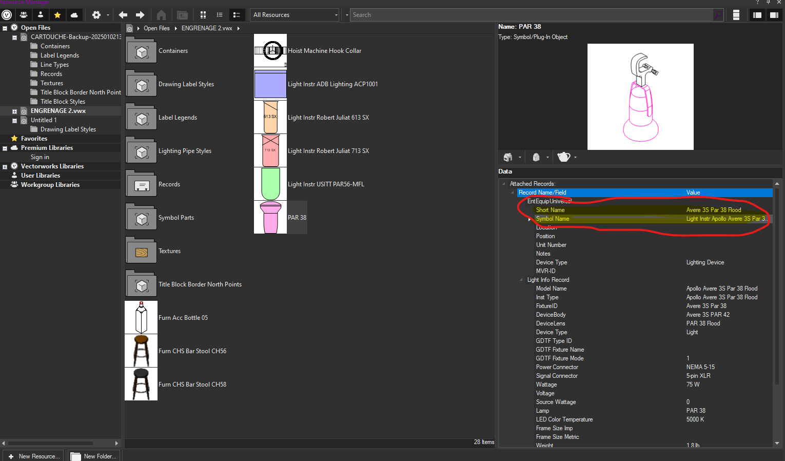

Enzo Vernusse Posted January 17 Share Posted January 17 Hello everyone, is it possible to change fixture symbole name or name fixture ? Or change fixture name in symbole key ? Quote Link to comment
Vectorworks, Inc Employee JustinVanHassel Posted January 17 Vectorworks, Inc Employee Share Posted January 17 You can change the name of a symbol in the Resource Manager by right clicking on it and choose rename. To change the name of a symbol in the Record Format attached to the symbol you have to go into 2D or 3D component and change the information in the record in the Data Pane of the OIP. Quote Link to comment

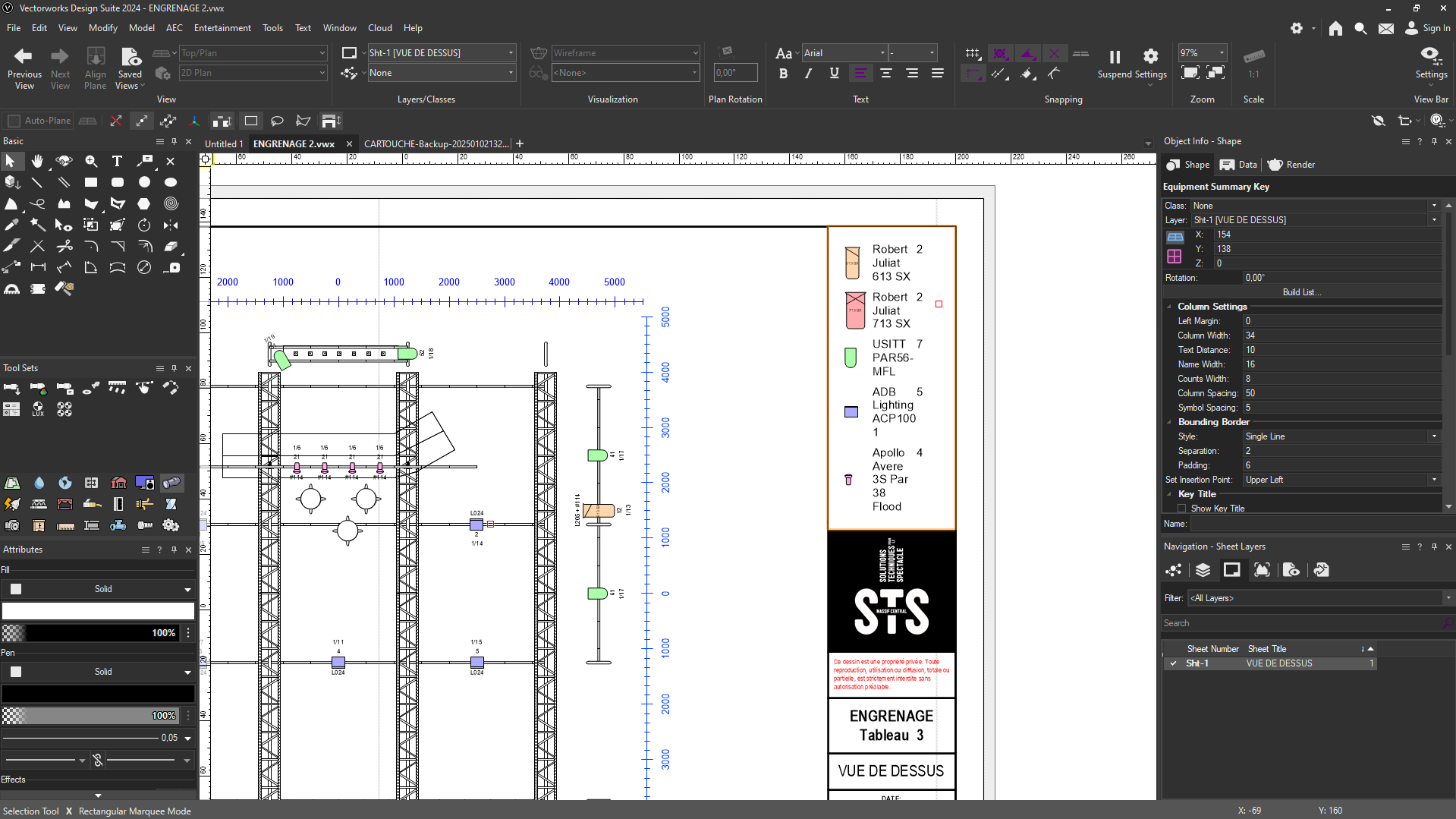

Enzo Vernusse Posted January 18 Author Share Posted January 18 Thank you for your response, unfortunately I explained my problem poorly. I want to rename the fixtures located in my symbole key so I thought I had to go to the resource Manager and change the short name or the name symbol but I think it's the name model that needs to be changed ? Quote Link to comment
Vectorworks, Inc Employee Scott C. Parker Posted January 27 Vectorworks, Inc Employee Share Posted January 27 In the Light Info Record attached to the light symbol, edit the Inst Type field. That's where the summary key grabs the name from. Quote Link to comment
