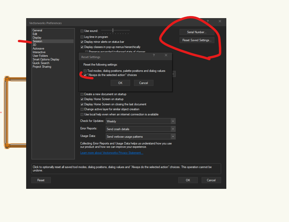

Ben3B Posted January 16, 2025 Share Posted January 16, 2025 Hello ungroup not working on symbol made by me with the "convert to group "checked problem ungroup.mp4 probleme symbole group.vwx Quote Link to comment
0 Tom W. Posted January 16, 2025 Share Posted January 16, 2025 It Ungroups as expected for me. Have you tried closing the file + restarting VW? Quote Link to comment
0 Ben3B Posted January 16, 2025 Author Share Posted January 16, 2025 it dont works on my PC even after restart vector ... but it works as expected on my laptop ...😈 Quote Link to comment
0 markdd Posted January 16, 2025 Share Posted January 16, 2025 Ungroups fine for me too.... However, I see this alert. I wonder if, at some point you activated the "always do" check box and this is reason why you are seeing this problem. Try reverting the alerts back to the defaults from the Reset Saved Settings in Vectorworks preferences. 2 1 Quote Link to comment
0 Ben3B Posted January 16, 2025 Author Share Posted January 16, 2025 (edited) @markdd thank you so much !!! it works!!!! You are better than french support :! Edited January 16, 2025 by Ben3B Quote Link to comment
0 markdd Posted January 16, 2025 Share Posted January 16, 2025 13 minutes ago, Ben3B said: thank you so much !!! it works!!!! Glad that was the answer! Quote Link to comment
0 Ben3B Posted January 17, 2025 Author Share Posted January 17, 2025 Thanks for your help but it is a normal way or not ? If it is normal, this is not easy to understand, there is no popup to help to find the "problem" Quote Link to comment
0 benAU Posted May 13, 2025 Share Posted May 13, 2025 On 1/16/2025 at 11:33 PM, Ben3B said: @markdd thank you so much !!! it works!!!! You are better than french support :! thanks for the screen shot... fixed my problem too 1 Quote Link to comment
