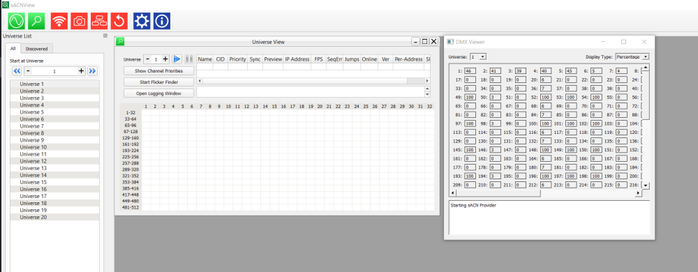

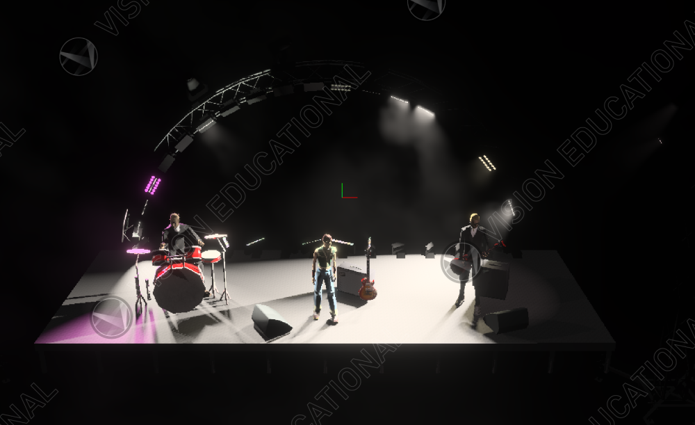

kaowki16 Posted January 6, 2025 Share Posted January 6, 2025 My vision connectivity has a mind of its own. When it works, it works perfectly; when it doesn't, it's this mess of random data. A simple relaunch of the program can cause this issue, and I don't know what I'm doing wrong. Help! I'm using MA2 on PC on the same computer but this issue persists even if that is not open. Quote Link to comment

Vectorworks, Inc Employee Mark Eli Posted January 6, 2025 Vectorworks, Inc Employee Share Posted January 6, 2025 This looks like there's another sACN source on the network. When I say somewhere on the network, that could be somewhere in the room with you, somewhere in the building, or even larger areas depending on how things are setup. The simplest way to test would be to switch to a different network that isn't attached to the first. Alternatively, if you have a unused router/managed switch, you can connect your computer to it. Nothing else needs to be connected to the router, it is just there to give windows a connection and IP address. There is the possibility that unplugging the computer from the network could work, but it's the least likely. Windows can disable the network interface when nothing is plugged in. If that's not possible, you can also try switching to Artnet. This is a less desirable solution because it's possible for the other source to be transmitting sACN and Artnet simultaneously. If it's not though, it should resolve the issue. As a side note, sACNView is a wild goose chase. It's settings and version of the sACN standard is different from Vision. So, it works sometimes, doesn't others, and there's no way to tell the difference. 1 Quote Link to comment

BScott Posted April 1, 2025 Share Posted April 1, 2025 (edited) Hello! I am having a similarly strange issue. Vision is detecting sACN data even when no other programs are running. I tried shutting down my computer completely and only opening Vision on the restart. The DMX viewer is still showing sACN data on every universe but sACNView doesn't show any DMX activity. What could cause this? I'm on a MacBook Pro M3 running Sequoia 15.1.1 and using the most recent version of Vision 2025. Scott Edited April 1, 2025 by BScott Quote Link to comment
Vectorworks, Inc Employee Mark Eli Posted April 2, 2025 Vectorworks, Inc Employee Share Posted April 2, 2025 On 4/1/2025 at 10:49 AM, BScott said: Hello! I am having a similarly strange issue. Vision is detecting sACN data even when no other programs are running. I tried shutting down my computer completely and only opening Vision on the restart. The DMX viewer is still showing sACN data on every universe but sACNView doesn't show any DMX activity. What could cause this? I'm on a MacBook Pro M3 running Sequoia 15.1.1 and using the most recent version of Vision 2025. Scott Hi Scott, I've seen this behavior in both Vision and Showcase on my macbook. The first time you see it can be a little confusing, but the good news is it's not an unknown behavior. In my experience this only occurs when there is no sACN stream coming into the macbook, or in the case that the sACN stream has been running prior to Vision being started which causes Vision to not be able to see the steam. In the case of no sACN, once the console starts sending, it should clear everything up. In the case of the sACN stream has been running prior to Vision being started. Shut down the console/show file, restart Vision, load your file, then restart the console. Generally speaking, it's always best practice to have Vision running with the file open prior to started your console. If for some reason you don't have anything that can send sACN and you want to work with the file without all your lights doing weird things. Switch your DMX Provider to Artnet. Quote Link to comment
CtrlDesign Posted June 30, 2025 Share Posted June 30, 2025 On 4/2/2025 at 5:32 PM, Mark Eli said: Hi Scott, I've seen this behavior in both Vision and Showcase on my macbook. The first time you see it can be a little confusing, but the good news is it's not an unknown behavior. In my experience this only occurs when there is no sACN stream coming into the macbook, or in the case that the sACN stream has been running prior to Vision being started which causes Vision to not be able to see the steam. In the case of no sACN, once the console starts sending, it should clear everything up. In the case of the sACN stream has been running prior to Vision being started. Shut down the console/show file, restart Vision, load your file, then restart the console. Generally speaking, it's always best practice to have Vision running with the file open prior to started your console. If for some reason you don't have anything that can send sACN and you want to work with the file without all your lights doing weird things. Switch your DMX Provider to Artnet. I am seeing Similar issues. Computer on network, See's sACN from an unknown source. sACN View sees nothing, I dont see ACN packets in Wireshark. Vision 2025 see's something. Ive tried restarting, Ive tried starting vision first. Ive tried having sACN generated by a 3rd party device (Pharos) and locally from sACN view. What I find odd, is Vision should request network access in Sequoia and It has not, so I am not sure how its accessing a network connection period. Quote Link to comment
