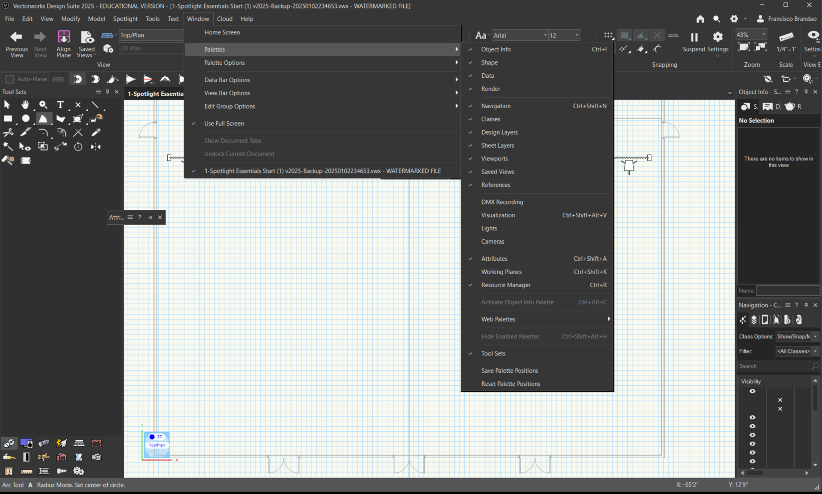

The basic tool palette is there, top left. In menu, it’s the tool sets.
the basic tool palette is called view/draw and it is part of the tool sets.

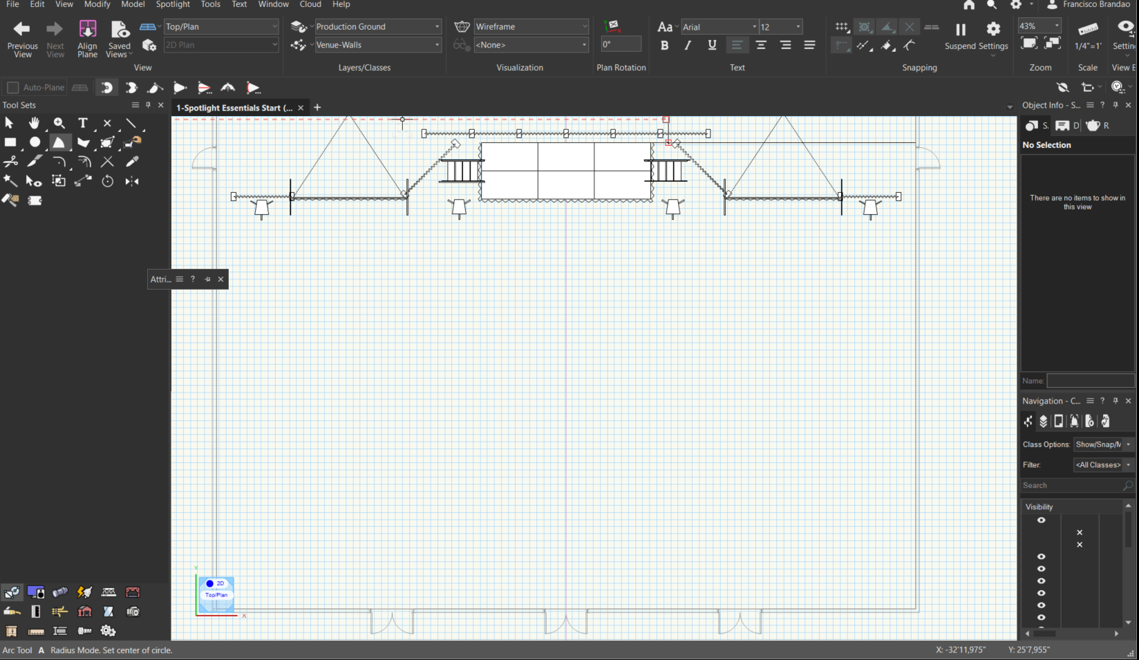

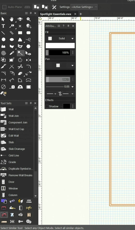

So how would I get it looking like this:
Link to comment
  • 0
In my commercial version of VW2025 (Designer) I just switched to the Fundamentals workspace and it looked like you want it to with the separate Basic tool palette.

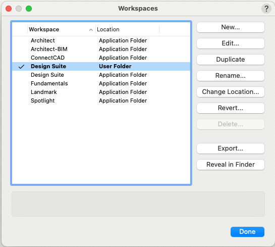

If you go to the Tools menu:Workspaces and select Workspaces....  Where does it say the location of the workspace you have selected is?  If it is in your user folder, then it has been customized.  Pick the one from the Applications folder and you should have the absolute stock version.
