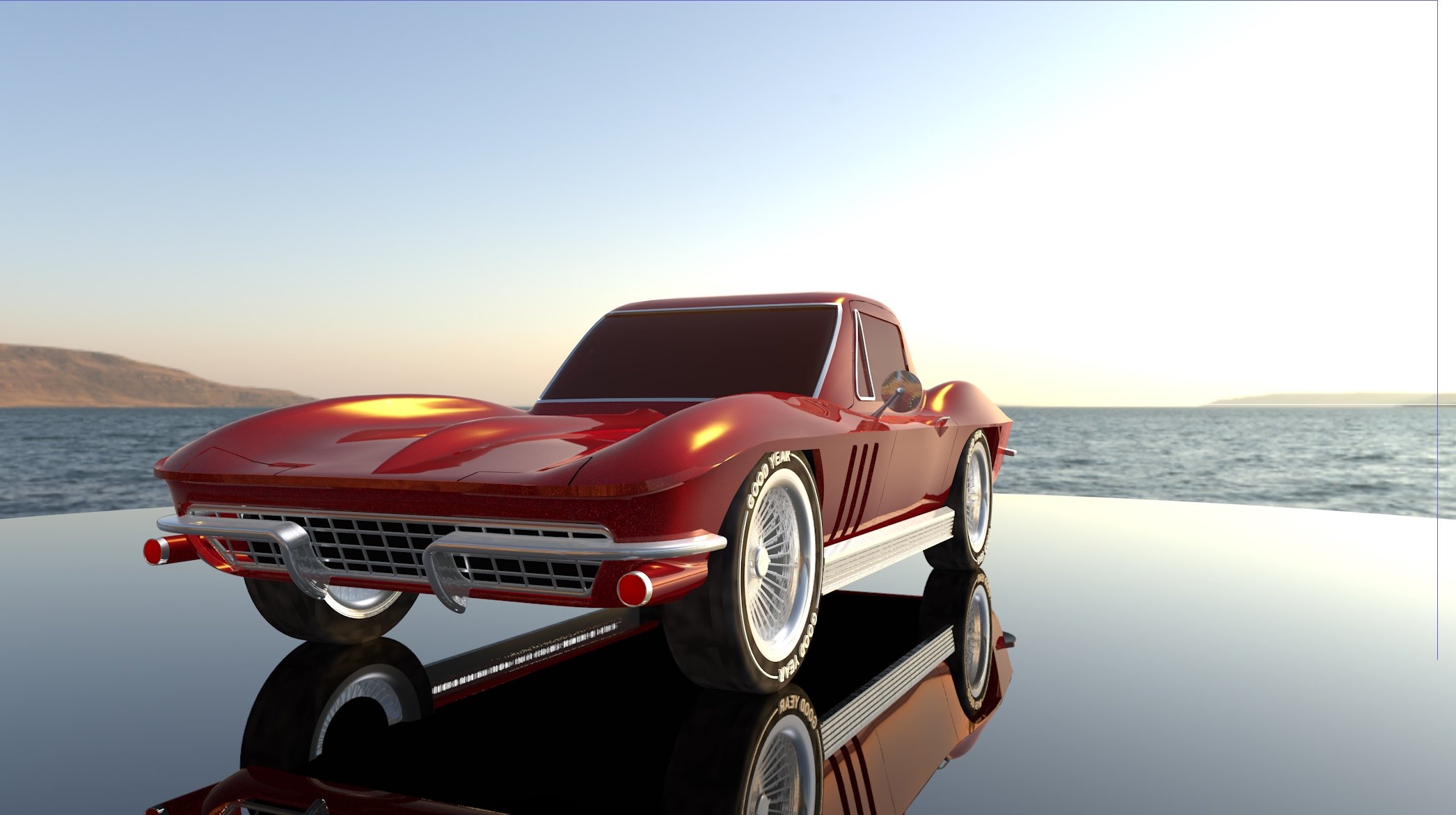

Vectorworks, Inc Employee Popular Post Dave Donley Posted January 13, 2025 Vectorworks, Inc Employee Popular Post Share Posted January 13, 2025 Metallic and other reflectivity shaders have clear coat as an option, if you set the clear coat to non-zero we do the layering of the texture for you "under the hood" Here is my attempt at a nice metallic light blue car paint. Metallic Car Paint.vwx 5 Quote Link to comment
grant_PD Posted January 13, 2025 Share Posted January 13, 2025 @Dave Donley That's great! I stand corrected! Is there an ability to add in a roughness map as well? it looks like the roughnesses are just generic. 2 Quote Link to comment
Vectorworks, Inc Employee Dave Donley Posted January 13, 2025 Vectorworks, Inc Employee Share Posted January 13, 2025 Hi @grant_PD roughness maps and more maps for textures is on our radar for future improvement. 4 Quote Link to comment

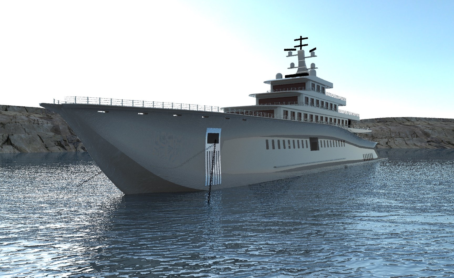

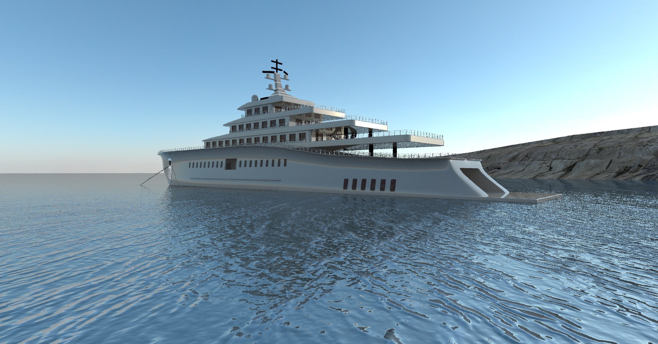

VIRTUALENVIRONS Posted January 15, 2025 Share Posted January 15, 2025 On 1/13/2025 at 10:42 AM, grant_PD said: So while you could model this car accurately in vectorworks, and you could give it a glossy blue paint finish, you could not (AFAIK) get the multiple reflections from renderworks. I do agree, Vectorworks does not have, but probably does not need the multiple reflections. Architecture tends to be more flat than reflective. I am spending more time with VW's rendering. I did not really understand backgrounds when I made the animation as I came back to it after ten years, but up to speed now. I like it. For reflections, adding light sources to the scene will create reflections. Also, the added light shows something that was not apparent in the animation. The paint is metallic. 1 Quote Link to comment
