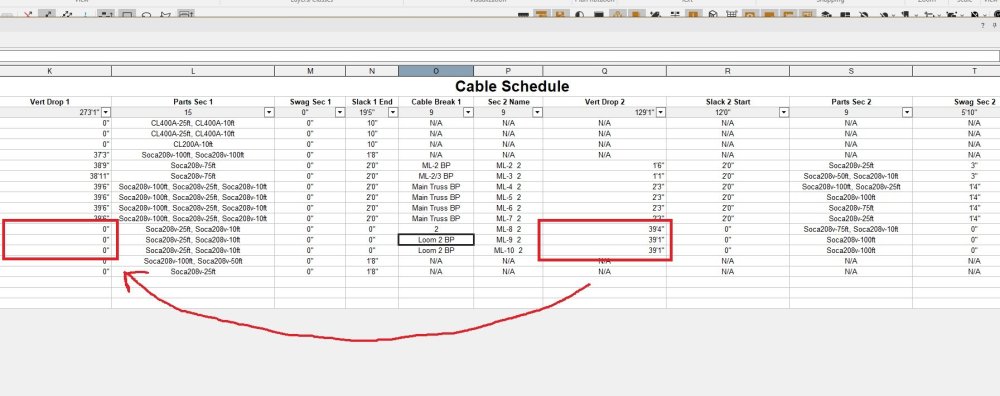

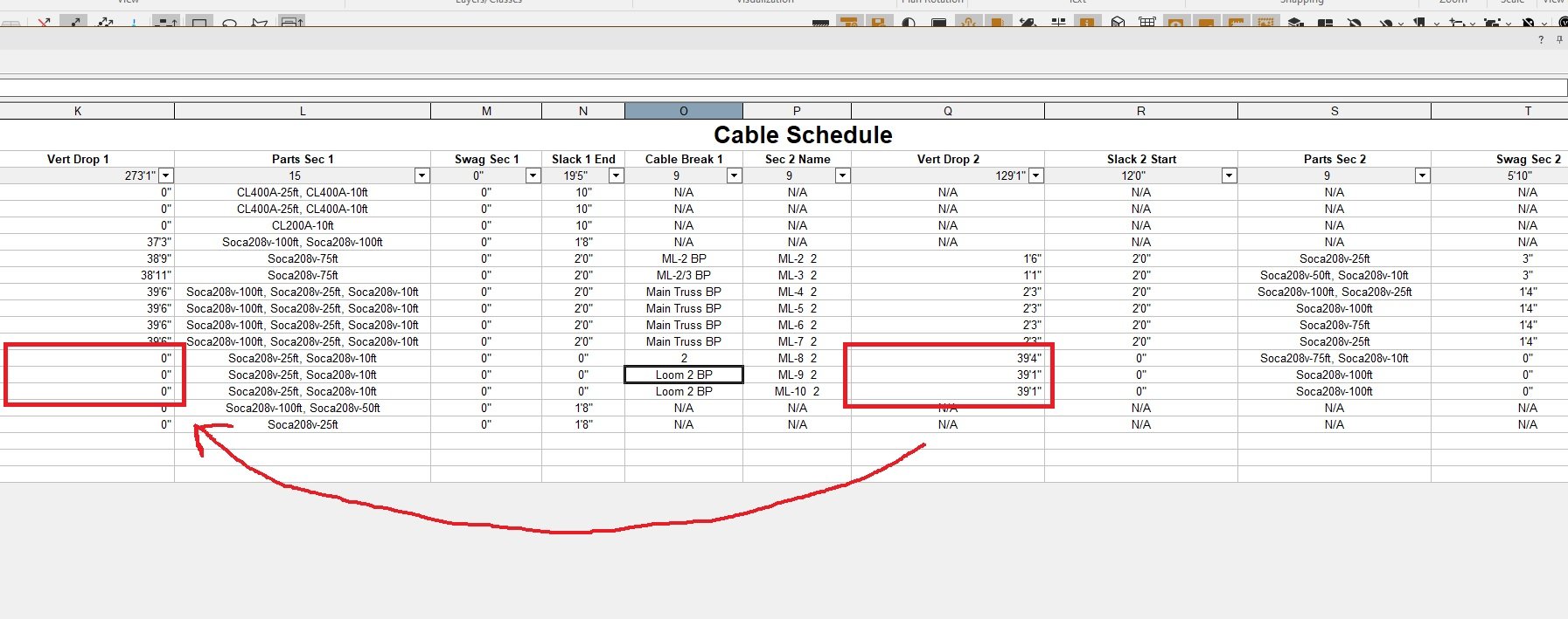

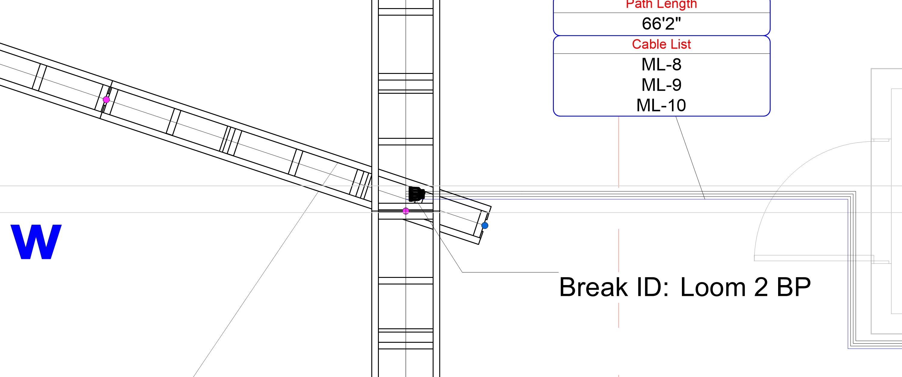

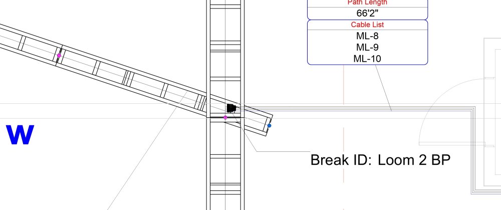

Leonarddel Posted December 17, 2024 Share Posted December 17, 2024 In the images you can see I have a 3 35' runs based off 1-25' and 1-10'. How would I force it to use a 50' cable for all 3? since I can just figure 8 15' IRL next to the distros. Another situation is I placed a Breakpoint but the Vert Drop is on Part Sec 2 but needs to be on Part Sec 1. Is there a way to move Vert Drop 2 to Vert Drop 1? Quote Link to comment
Vectorworks, Inc Employee Scott C. Parker Posted December 17, 2024 Vectorworks, Inc Employee Share Posted December 17, 2024 Quickest way is to add five or ten feet to the Slack fields. 1 Quote Link to comment
Vectorworks, Inc Employee Scott C. Parker Posted December 17, 2024 Vectorworks, Inc Employee Share Posted December 17, 2024 36 minutes ago, Leonarddel said: Vert Drop is on Part Sec 2 but needs to be on Part Sec 1. Playing with the slack fields might help here. But, you might need to move the break point. I haven't played with this in the way you describe. Quote Link to comment

Vectorworks, Inc Employee jcogdell Posted December 20, 2024 Vectorworks, Inc Employee Share Posted December 20, 2024 in the cable preferences set the cable use the fewest parts possible in the drop down and then set the threshold to the largest increment used in your cable parts set or library. for example if you are using metric part set the threshold to 10m since this is the largest length increment between the different metric cable part lengths. 1 Quote Link to comment
