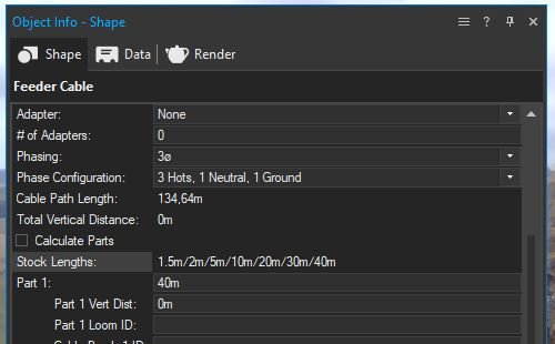

BTD77 Posted December 13, 2024 Share Posted December 13, 2024 Hi, I've created a Feeder Cable with the Feeder Cable Tool. In the palette Object Info the Stock Lengths item is set at 1.5m/2m/5m/10m/20m/30m/40m. Does anyone whos who to edit this (ea : 1.5m/2m/5m/10m/20m/30m/40m/50m) ? Quote Link to comment
Vectorworks, Inc Employee Scott C. Parker Posted December 13, 2024 Vectorworks, Inc Employee Share Posted December 13, 2024 Hello, the picture you show is of the prior version of the cable tools. If you want to continue using the workflow offered via this version, @Sam Jones offers an updated version. The current version of VW cable and power tools has a different method of making cables. The cables are stored in the Cable.vwx files found in the RM. Quote Link to comment
