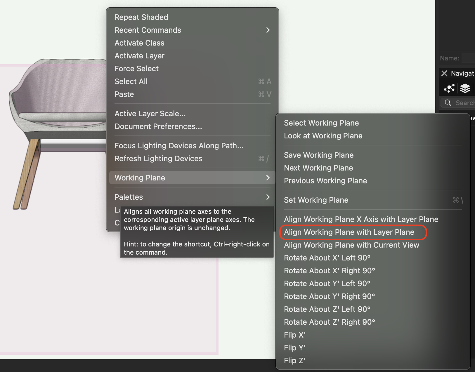

0 Popular Post markdd Posted December 12, 2024 Popular Post Share Posted December 12, 2024 Right Click, then Working Plane sub-Menu. 5 Quote Link to comment
