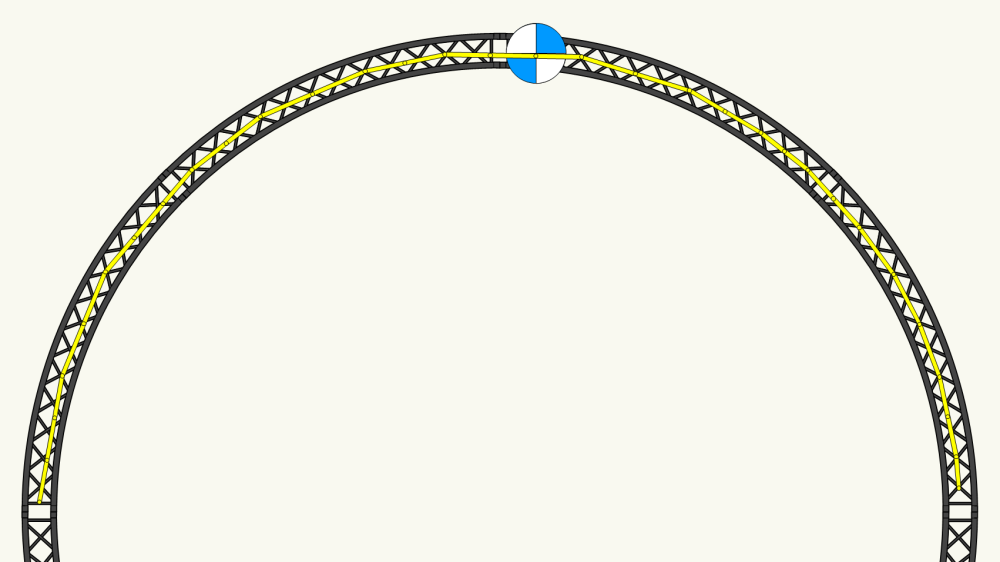

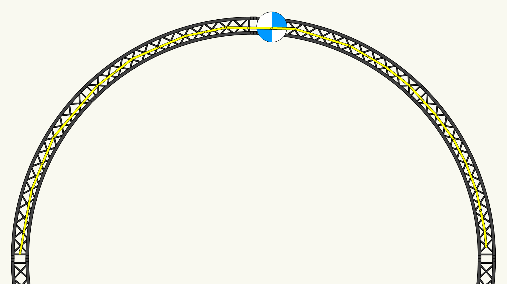

Michael Schroeder Posted December 21, 2024 Share Posted December 21, 2024 Select the hanging position/trusses, then go to the Braceworks menu and select "Insert Distributed Load at Selection" 2 Quote Link to comment
Peter Telleman Posted December 23, 2024 Author Share Posted December 23, 2024 @Michael Schroeder Thanks a million! that works awesome! Quote Link to comment
