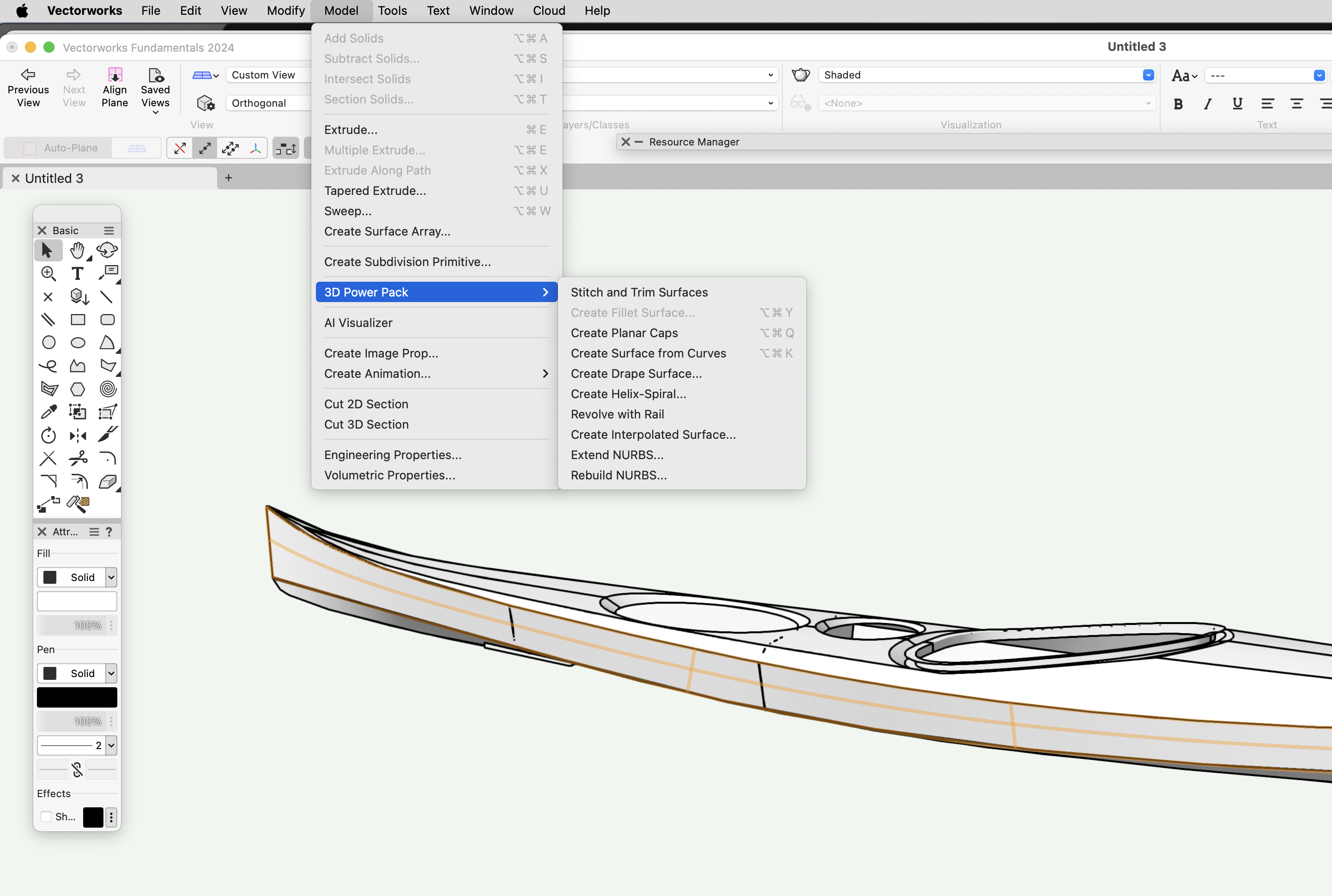

Guillemot Posted December 3, 2024 Share Posted December 3, 2024 I see documentation talking about it existing under the 3D Power Pack menu but it is not there for me. I use Rhino and other tools to do this now, but it would be nice to have a tool available within Vectorworks. 1 Quote Link to comment
Pat Stanford Posted December 3, 2024 Share Posted December 3, 2024 It is in the 3D power pack in the VW2025 Designer workspace. If you are using a custom workspace you might need to add it using the Workspace Editor. Quote Link to comment
Claes Lundstrom Posted December 4, 2024 Share Posted December 4, 2024 10 hours ago, Pat Stanford said: It is in the 3D power pack in the VW2025 Designer workspace. If you are using a custom workspace you might need to add it using the Workspace Editor. It's not there in Fundamentals, so only in some versions. I don't know if has evolved much over the years, since it was released as I never use it, despite using unfolding a lot. It always felt a bit like a half hearted to be honest. Quote Link to comment
VIRTUALENVIRONS Posted December 4, 2024 Share Posted December 4, 2024 I checked as far back as 2018 in Fundamentals and it is not part of that suit. I am guessing, but as this is a "Hybrid tool" of sorts that the relationship code between 2D and 3D is not there for "Unfold Surfaces". Quote Link to comment

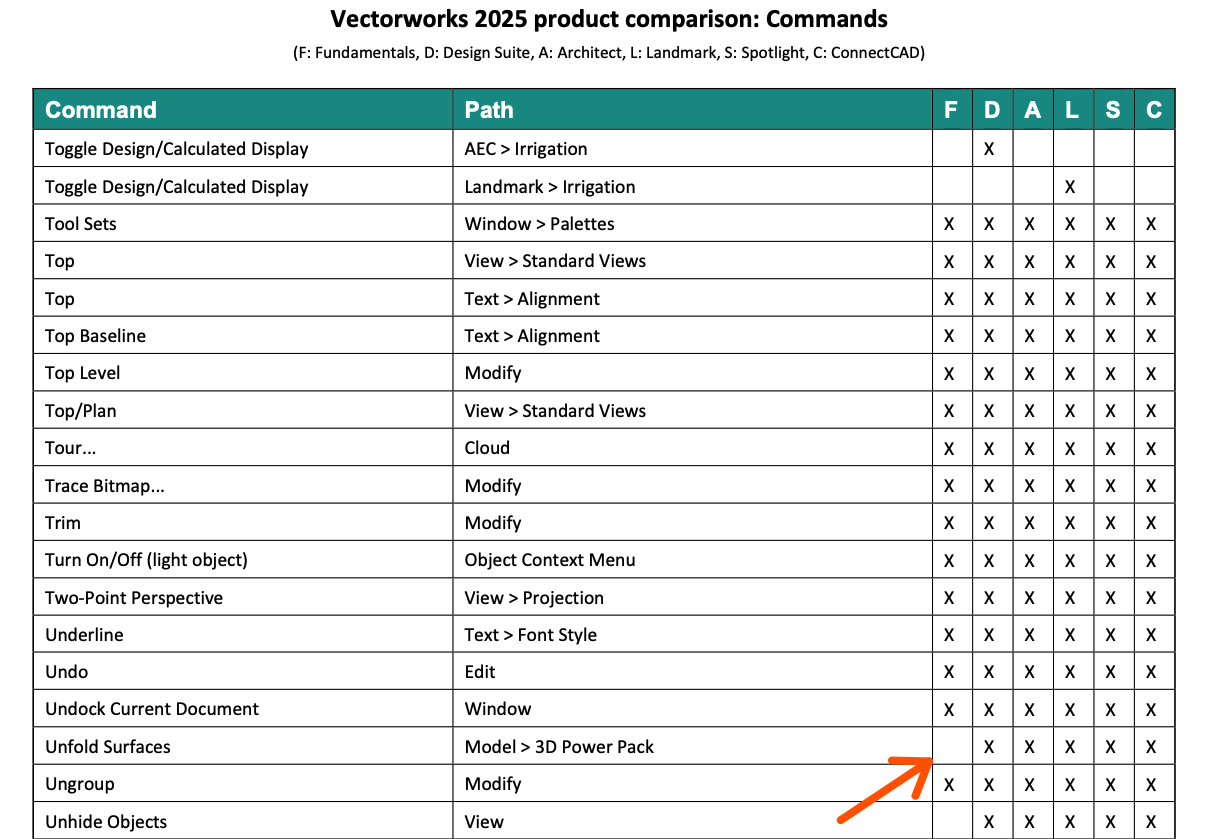

rDesign Posted December 4, 2024 Share Posted December 4, 2024 1 hour ago, VIRTUALENVIRONS said: I checked as far back as 2018 in Fundamentals and it is not part of that suit I am guessing, but as this is a "Hybrid tool" of sorts that the relationship code between 2D and 3D is not there for "Unfold Surfaces". No, based on the lower price of entry for Fundamentals, Vw decides which tools / plug-ins are included with Fundamentals. I don’t believe it has anything to do with the underlying code, it’s simply that Vw does not include that functionality with Fundamentals. 1 Quote Link to comment

Pat Stanford Posted December 4, 2024 Share Posted December 4, 2024 VW has already documented this in the product comparison: 2025 Product Comparison 2 Quote Link to comment
Guillemot Posted December 4, 2024 Author Share Posted December 4, 2024 10 hours ago, Claes Lundstrom said: It's not there in Fundamentals, so only in some versions. I don't know if has evolved much over the years, since it was released as I never use it, despite using unfolding a lot. It always felt a bit like a half hearted to be honest. That was one of my guesses. I am using Fundamentals, so that explains it. Between Rhino and my naval architecture specific design tools I probably have better options, but I thought it was something that Vectorworks should offer and when I went to see if it did, I was surprised when I found it as an available tool, but it was not available for me. I will say that the distinctions between Fundamentals and the others can seem fairly arbitrary. Tools that I used to have such as "Hide" and "Unhide" objects is now "Object Visibility..." and no longer available in Fundamentals. I've been using Vectorworks since it was MiniCad and "Hide" has been available since early days. I don't know exactly when it became a high-end feature, but I guess renaming something is one way to create an upgrade of a feature. Quote Link to comment
