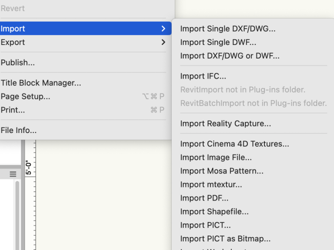

tdmaine Posted December 1, 2024 Share Posted December 1, 2024 I can't import revit in 2025 it's greyed out. I tried reinstalling and repairing . Can anyone help? Thanks Quote Link to comment

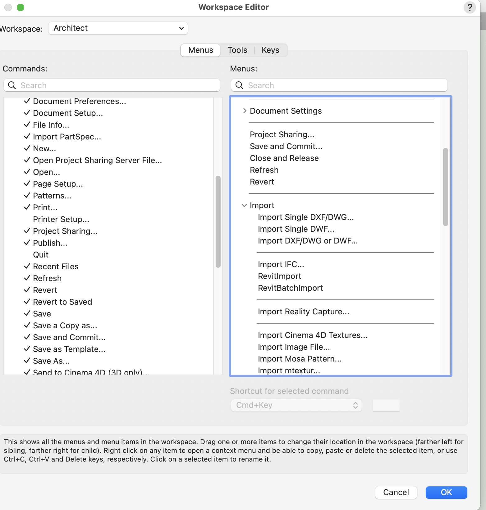

0 zoomer Posted December 1, 2024 Share Posted December 1, 2024 Maybe you use a (migrated ?) customized Workspace, that shows older RVT import entries, which VW might have replaced for newer versions. To check this you could temporarily change to one of VW's default Workspaces. If it works there, you could edit you custom Workspace. By deleting your corrupt entries and add them from the left list again. If it does not work with a default Workspace, I would close VW, run the Updater/Installer directly from App Directory and try to run the "Repair" option. Quote Link to comment
0 tdmaine Posted December 1, 2024 Author Share Posted December 1, 2024 43 minutes ago, zoomer said: Maybe you use a (migrated ?) customized Workspace, that shows older RVT import entries, which VW might have replaced for newer versions. To check this you could temporarily change to one of VW's default Workspaces. If it works there, you could edit you custom Workspace. By deleting your corrupt entries and add them from the left list again. If it does not work with a default Workspace, I would close VW, run the Updater/Installer directly from App Directory and try to run the "Repair" option. Thanks I tried repairing already, Reinstalled 2025 completely and im in default workspace and it shows revit import available 😞 but its not on the menu. Also tried toggling between them to no avail t Quote Link to comment
0 Tom W. Posted December 1, 2024 Share Posted December 1, 2024 Can I check that you tried removing the commands from the workspace then adding them back in again…? (as per @zoomer’s suggestion) 1 Quote Link to comment
0 Dan Reed Posted December 2, 2024 Share Posted December 2, 2024 I am seeing the same issue as tdmaine- running VW 2025 MacOS Update 2. Greyed out "RevitImport not in Plug-ins folder" & "RevitBatchImport not in Plug-ins folder" messages and no Revit import options in the workspace editor. I believe I imported a Revit with same version in Win10 only a few days ago... Quote Link to comment

0 Hans-Olav Posted December 4, 2024 Share Posted December 4, 2024 Its the same here, Greyed out "RevitImport not in Plug-ins folder" & "RevitBatchImport not in Plug-ins folder" messages and no Revit import options in the workspace editor. Its seems Revit Import is totally missing frim the instalation. I have tried repair and install manager saying nothing to repair @Dave Donley can you help? Quote Link to comment
0 Tom W. Posted December 4, 2024 Share Posted December 4, 2024 1 minute ago, Hans-Olav said: Its the same here, Greyed out "RevitImport not in Plug-ins folder" & "RevitBatchImport not in Plug-ins folder" messages and no Revit import options in the workspace editor. Its seems Revit Import is totally missing frim the instalation. Yes I meant to say that I am seeing the same (so the commands are not there to remove + add back in again). Quote Link to comment
0 Hans-Olav Posted December 4, 2024 Share Posted December 4, 2024 I have tried architect workspace, design suite workspace, architect-BIM workspace and no-one have revit import option Quote Link to comment
0 Vectorworks, Inc Employee Ian Lane Posted December 4, 2024 Vectorworks, Inc Employee Share Posted December 4, 2024 On 12/1/2024 at 9:37 AM, tdmaine said: I can't import revit in 2025 it's greyed out. I tried reinstalling and repairing . Can anyone help? Thanks 1 hour ago, Hans-Olav said: I have tried architect workspace, design suite workspace, architect-BIM workspace and no-one have revit import option We went live with update 2.1 this morning that contains a fix for this problem. It is a problem with intel macs. Thanks for helping us find the problem so quickly. 2 Quote Link to comment
