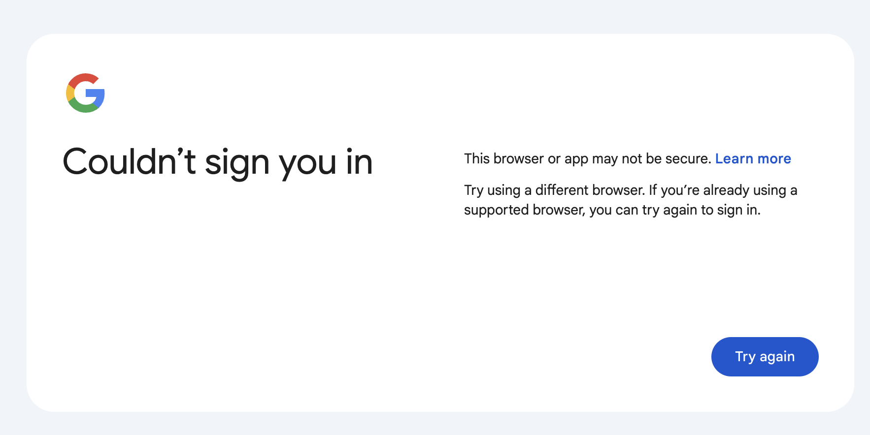

Hello,
I've just updated to 2025.2, wanted to check the new features of AI visualizer. (I opened also cloud services, which is also up to date)
AI window asked me to login. I always login with my google account, but it didn't work automatically (by clicking google icon), it askd my email. After I gave my adress it didn't ask my code, just this message:
Unsuccessful login
It is possible that this browser or application is not secure.
Try using a different browser. If you are already using a supported browser, try logging in again.
Then I cleaned the cookies and cach of both my browsers: edge and chrome, but the same happens.
With previous versions Everything was OK.
What can be the solution?
Thanks for any help!

Hi @inikolova, thank you!
I have no problem with  signing in to my vectorworks account or cloud services. Everything works fine just like before: I can use my google social login with just pressing the google button.
But it doesn't work the same way when I start AI visualizer. If I try to sign in with my email and code, it gives an error message: not valid email, although I use the valid email and code.
When I want to use the social button, it doesn't let me in, asks my email. After  giving it, I get the error message:
Unsuccessful login
