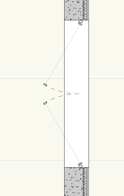

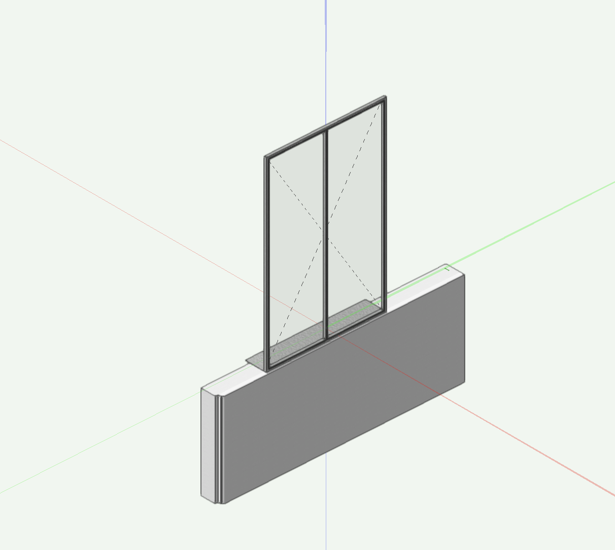

Gal Posted November 19, 2024 Share Posted November 19, 2024 I can't seem to be able to make the wall closure operate. Any ideas? I'm on a Window machine, version 2023. Gal Quote Link to comment

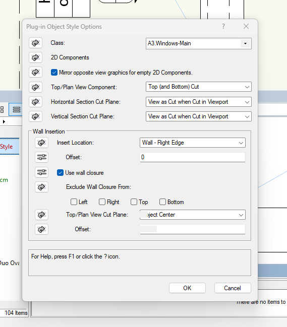

Tom W. Posted November 19, 2024 Share Posted November 19, 2024 Do you have Use Wall Closures enabled for the Insert (the Window)? Right click on it + check PIO Options (if By Style you'll need to right click on the Style in the Resource Manager). Quote Link to comment
Gal Posted November 19, 2024 Author Share Posted November 19, 2024 Thanks Tom, I do Quote Link to comment

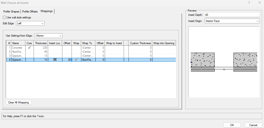

Tom W. Posted November 19, 2024 Share Posted November 19, 2024 What is the 30mm offset for? What happens if you get rid of this + check 'Wrap to Insert'...? Otherwise post the file. Quote Link to comment

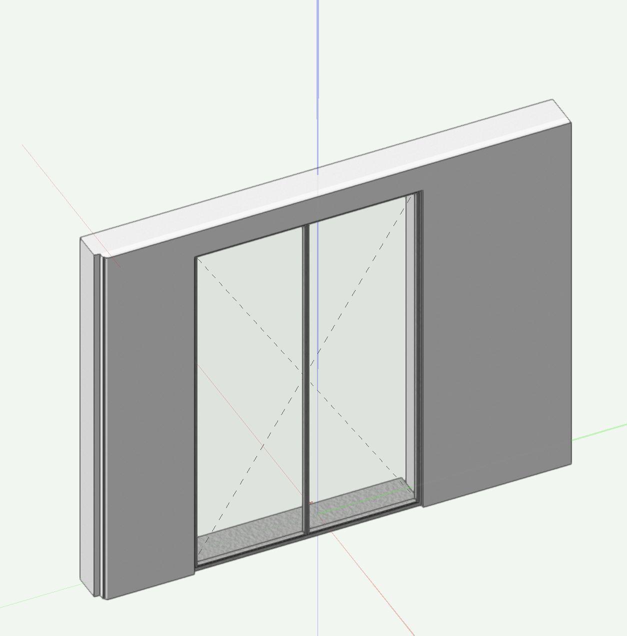

Tom W. Posted November 19, 2024 Share Posted November 19, 2024 Ok this is what I'm seeing in 3D: You need to give your Wall height: I am working in VW2025 otherwise I'd have sent the file back sorry. Quote Link to comment

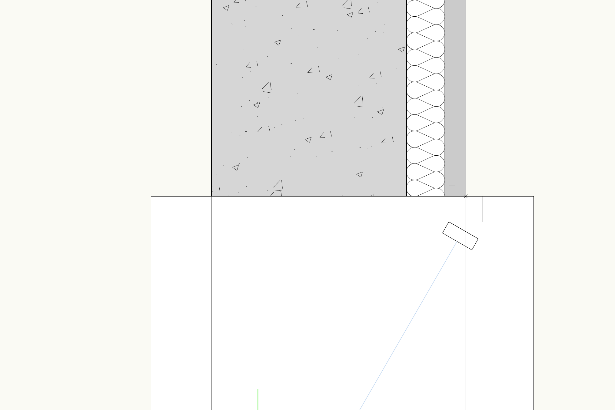

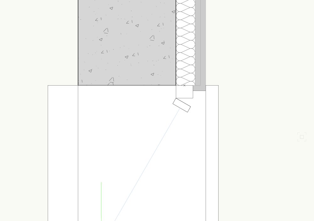

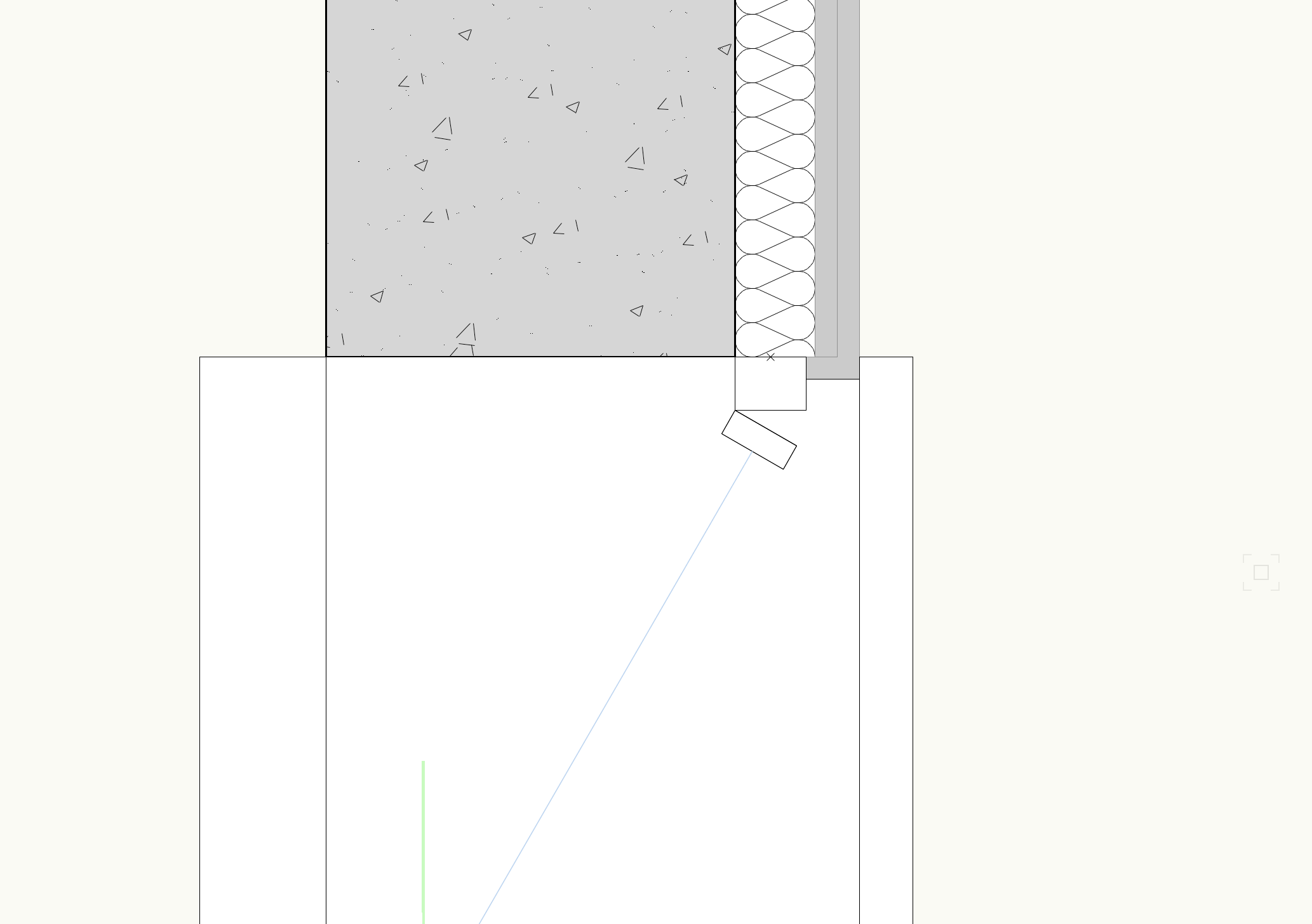

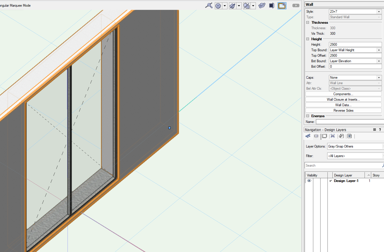

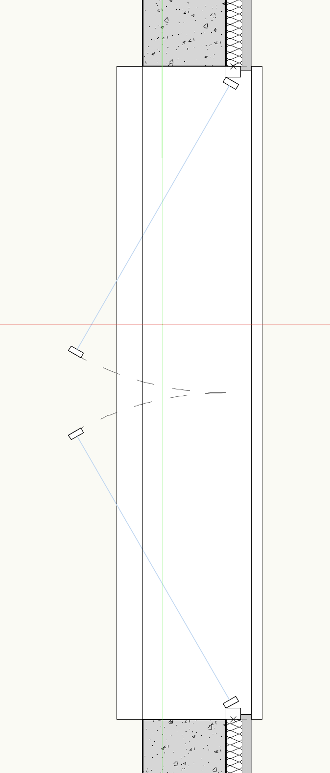

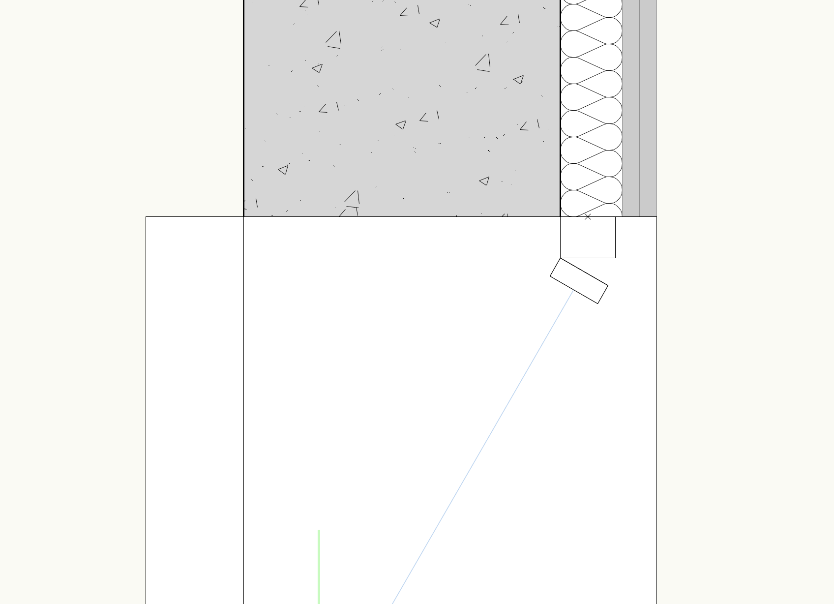

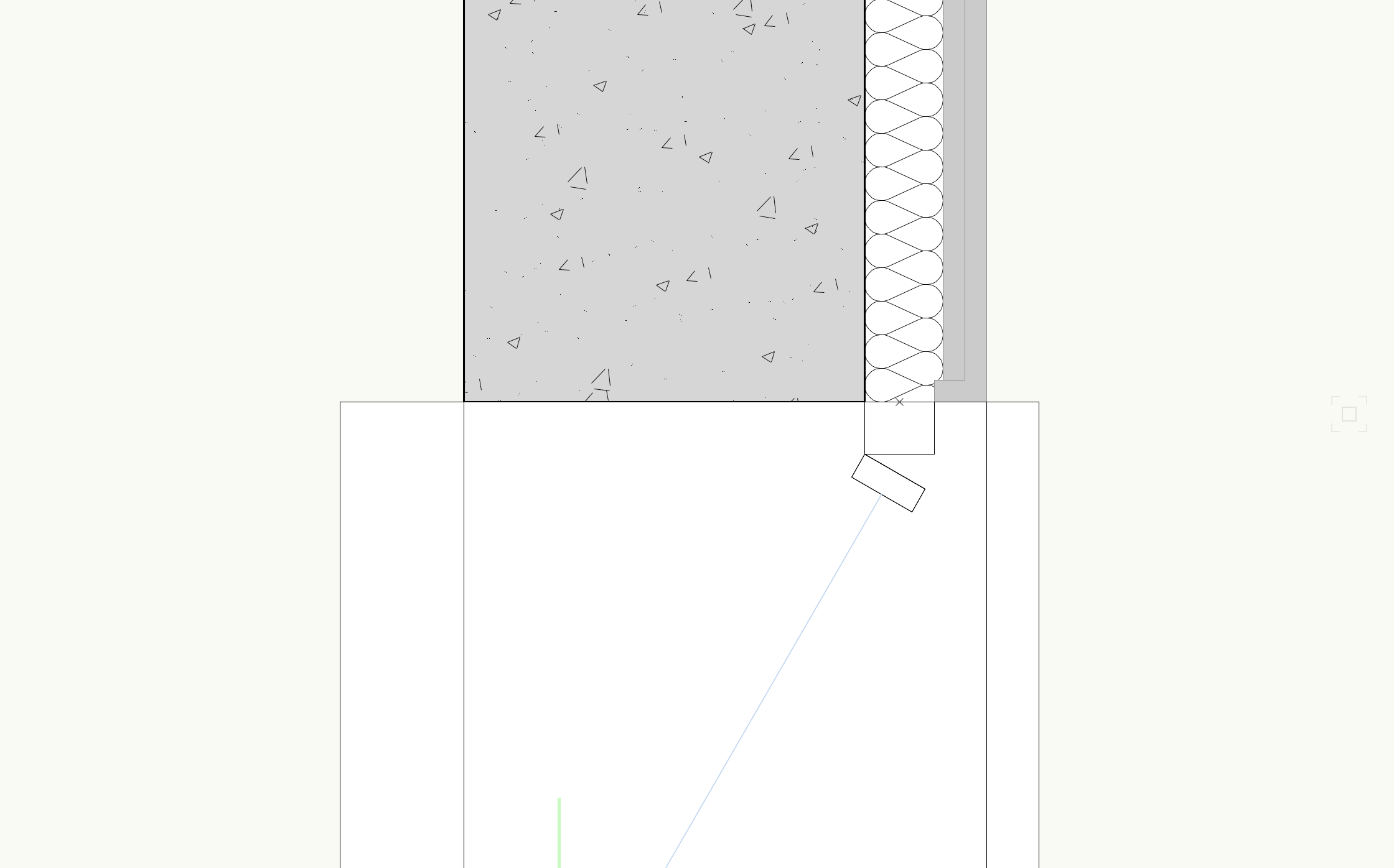

Tom W. Posted November 19, 2024 Share Posted November 19, 2024 When I open your file I see this: When I open the PIO Options + click OK it changes to this: When I then apply an offset of 50mm in the OIP I get this: Then if I enable 'Wrap into Opening' in the Wall Closure settings I get this, which I think is what you want?: 1 Quote Link to comment
Gal Posted November 19, 2024 Author Share Posted November 19, 2024 Amen. Thanks Tom Quote Link to comment
