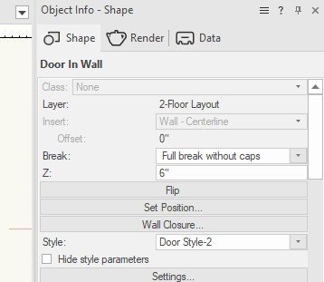

Rutuja Posted November 8, 2024 Share Posted November 8, 2024 Hello! I'm working on a Renovation project where I need to add my Door in Existing Door Class. It only allows me to change class for unstyled doors I already have doors in the file I want to change their class for many doors at once. Can someone help me to understand where is the door taking Class none from and how can I change it? Does anyone have suggestions on what is the best way to represent Existing, Demolition and New Doors ?? Quote Link to comment
Jonathan Pickup Posted November 8, 2024 Share Posted November 8, 2024 I would make the doors unstyled unless you have a lot of doors that are the same size. If you want to use styled doors, create the styled door required, then locate the door style in the Resource Manager, right-click on it and choose Plug-in Style Options. Change the class for the style here. 2 Quote Link to comment

shorter Posted November 9, 2024 Share Posted November 9, 2024 (edited) 2 hours ago, zoomer said: Even if different sizes .... VW should be able to edit multiple selected Doors at a time, to change Door parameters or even to resize multiple Doors of same size. Create a worksheet, and modify the values in the worksheet. Never leave Doors 'Unstyled'. The door can be styled and pretty much all parameters can be left as editable 'instance' parameters. I would create a Door Style, that is an 'Existing' door style, e.g. ABC_Door_Internal_Existing, but with the size parameters (and any other than might change) instance based. You could create more than one existing door style depending on what is constant about that particular set of doors. The doors style can then be classed (go to the plug-in object settings in the resource manager) or data attached via the IFC pset to do what @E|FA suggests. Note: IFC4 now allows for phasing in the IFC pset_DoorCommon (set the status parameter as Text and it gives you a pull down list). You can then select all doors via a worksheet and edit them en-masse. Tip: list the doors by using the 'summarise' filter in the worksheet. You can use the ifc property to highlight them as existing or demolished using data visualisation. Video and example file can be found here... https://www.dropbox.com/t/gFXppjuHHmqVMbB2 Edited November 9, 2024 by shorter 3 Quote Link to comment
