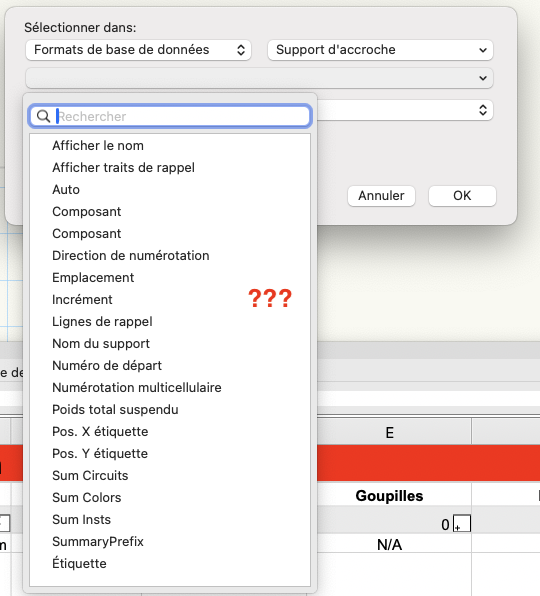

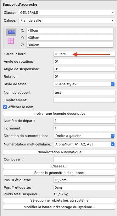

Rosa Prod Posted November 6, 2024 Share Posted November 6, 2024 Hi, Where i can find the Z height of an hanging position ? I can see it in the PIO of hanging position but not in the ressource of worksheet... Thanks Quote Link to comment

Vectorworks, Inc Employee jcogdell Posted November 15, 2024 Vectorworks, Inc Employee Share Posted November 15, 2024 Sorry missed this one, it looks like the new trim height parameter hasn't been revealed for reporting, I'll get a bug report in for it. until this is addressed select functions in the dropdownand in columns look for Zcoordinate in the Objects-General section. 1 Quote Link to comment
Rosa Prod Posted November 15, 2024 Author Share Posted November 15, 2024 Thanks for your answer...Unfortunately the Zcoordinate didn’t reflect the real height of the hanging position. As you can see with picture in the first post, the bottom of HP is 100cm but Z say 300cm. It's because i've used the trim fonction in the PIO... I hope it will be resolved soon because we have this problem for long time and it's an important information that we need in entertainment corporation. Thanks 🙏 Quote Link to comment
