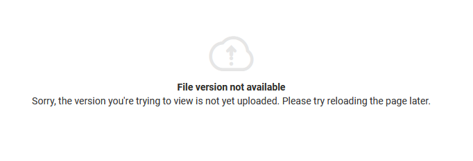

halfcoupler Posted November 14, 2024 Author Share Posted November 14, 2024 Thanks @inikolova for this answer, meanwhile I have listened to your very interesting coffebreak and think for me it will become a great tool for communication. But I have two problems: 1) - I definitely can not produce a shared document, It keeps stuck in this process: Switching to the history tab it keeps announcing: 'Pending Upload' Maybe this is a problem with the storage region server (Frankfurt) ? 2) - Clients have to sign in for comments. My clients will definitely not do this (for example imagine that you can not force any public authorities to sign in anywhere) . Hope there will be a solution for this in future. Quote Link to comment
Vectorworks, Inc Employee inikolova Posted November 14, 2024 Vectorworks, Inc Employee Share Posted November 14, 2024 @halfcoupler, Thank you for your positive notes about the webinar and the feature. The webinar was very useful for me as well, to learn what users expect from it and how we can evolve it. 1) It seems like the .vcdoc file is not yet uploaded. Things to check: - Did you click Share on the Vectorworks dialog, which actually triggers the file export? - Do you have Selective sync enabled in the Cloud Services desktop app? If yes, make sure the Shared Documents folder is selected for syncing. (We have a fix for this in the upcoming version of the desktop app) 2) Thanks for the feedback! I will pass it on to the team for consideration. This was actually part of my initial design proposal, but it wasn't completed as part of the inital release. I hope we would be able to come up with a solution for the subsequent releases. Quote Link to comment

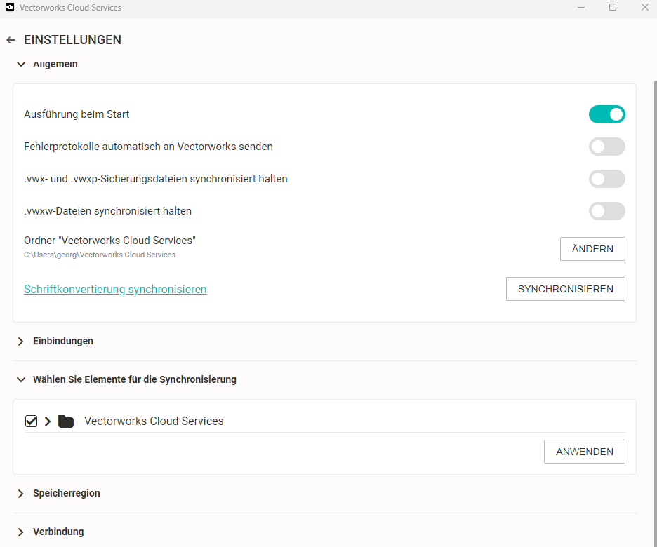

halfcoupler Posted November 14, 2024 Author Share Posted November 14, 2024 @inikolova , thank you for the quick reply 🙂 it is a bit confusing, can't find 'selective sync' setting in the cloud service destop app since there is a german version installed here and I can't locate the appropiate translation... Can you tell me where to find it ? And yes, I clicked 'share' 🙂 Quote Link to comment
Vectorworks, Inc Employee inikolova Posted November 14, 2024 Vectorworks, Inc Employee Share Posted November 14, 2024 Selective sync is the third section from the top, where you see the check mark next to the Vectorworks Cloud Services folder. If you click on it, it will expand to show you the folder structure inside the Vectorworks Cloud Services folder and which folders are set for syncing. But since you have a check mark on the root folder, that tells me all folders inside are selected as well, so selective sync is not your problem. Have you paused the syncing of the app entirely? The pause button is shown inside a teal circle, as on my screenshot below. When you open the Cloud Services Desktop app, do you see the .vcdoc file in the Sync activity section? It would also help us troubleshoot if you enable sending app logs from the settings - the second option on the General section on the Settings dialog. Or you can zip up and email me the following folder: /Library/Logs/Nemetschek/Vectorworks Cloud Services to inikolova@vectorworks.net. Quote Link to comment
halfcoupler Posted November 15, 2024 Author Share Posted November 15, 2024 6 minutes ago, inikolova said: Have you paused the syncing of the app entirely? No 7 minutes ago, inikolova said: When you open the Cloud Services Desktop app, do you see the .vcdoc file in the Sync activity section? No 9 minutes ago, inikolova said: It would also help us troubleshoot if you enable sending app logs from the settings enabled now. I'm really tapping in the dark...😕 Quote Link to comment
halfcoupler Posted November 15, 2024 Author Share Posted November 15, 2024 14 minutes ago, inikolova said: Have you paused the syncing of the app entirely? uups,- yes. I think that was the problem,- I switched it on and off and now it is working, maybe it was indeed switched of before, so obviously the software workes as designed and the problem can be located between keyboard and office chair 😁 Thanks a lot for the help 😉😉😉 1 Quote Link to comment
