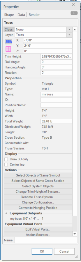

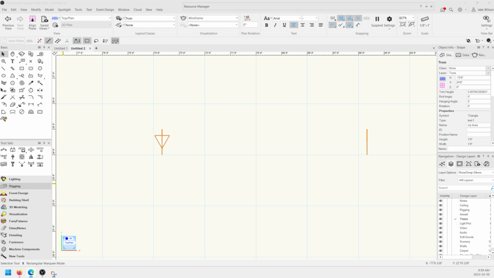

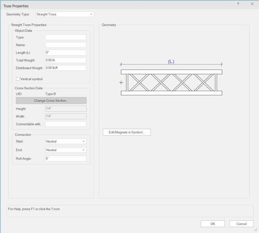

Jake Wilson Posted October 29, 2024 Share Posted October 29, 2024 Why is is that when I try to use the truss tool what was a simple process has become drawn out and convoluted? Why do I need to add the truss properties when my libraries are full of truss symbols? Why when I change the cross section to Christie B Type for example, do I still need to add name, type and weight? Why does this not get pulled from the libraries VW claims to have been building for decades to support customers? I don't feel very supported. Why when I add truss do I only get a 2D triangle symbol with a trim height of 5.8979433558475e305' What does this even mean? Why when I try to change the trim height nothing happens? Why does VW ask is I want to delete disconnected motors after last action, when all i've done is shift a stick of truss a few feet? FYI this is a stupid question and the answer is always NO! I will simply move the motors. This is not the "improvements" Vectorworks needs. Did anyone from Vectorworks bother to speak to daily average users in the entertainment industry? We don't need the truss tool to slow down out workflow, when I click the truss tool all I need it to do is add a stick of truss that I can choose from the libraries, set the position, length and height and move on with my job. And NO, I do not want to use the straight truss tool, which has always been garbage. I paid a lot of money for this software and I would be very happy if the legacy tools that work were left alone. Quote Link to comment

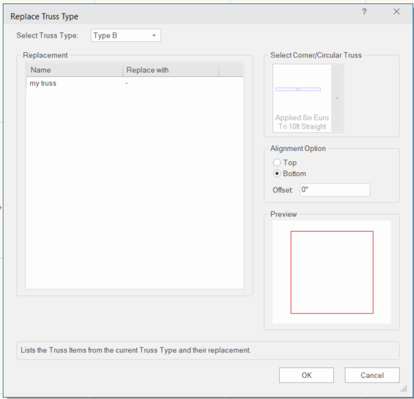

Jake Wilson Posted October 30, 2024 Author Share Posted October 30, 2024 Hi Scott, Thanks for the advice however I am using VW DS 2025 which I updated from 2024 less than a month ago, and I do keep my resource manager updated monthly. As mentioned this is a recent update so I can't see how the cache could be full, unless the cache folder does not clear during an update? The VW team keeps talking about workflow, work does not flow if I constantly have to stop working to add parameters to a symbol that was included in the libraries on all previous versions of the software. For example in the new truss properties popup I choose the change cross section option and pick B type, but nothing other than the name UID is added, Why has the tool not added the parameters to the symbol? Even after I have added the parameters manually the truss does not appear, only a triangle with magnets. When I right click and choose properties, the new truss properties window does not open, the OIP opens, why does this not open the new properties for the new tool? Then I try to replace the truss type using the rigging menu under the spotlight tab and I am forced to add an inventory, why? I use different truss all the time, its called cross renting, many companies do it to supplement their inventory during busy times and I cant always get truss to match my Prolyte and there are things even Prolyte can't do. This inventory idea is just a waste of time and does not work. I added all the truss from the VW library and when I choose B type nothing happens, in fact it does not matter what type of truss I choose the option only shows the truss I just tried to create. I have refreshed the truss inventory twice and i still cant use the B type truss I asked for. I don't need VW to be an inventory management system, I pay for Rental point for that. I need VW to be a design program. I need VW to stay in its lane and go pack to being a productive intuitive tool. The VW development team needs to be reminded that they are not the be all and end all, there are other games in town. Quote Link to comment

Vectorworks, Inc Employee Scott C. Parker Posted October 31, 2024 Vectorworks, Inc Employee Share Posted October 31, 2024 Hi Jake, I opened your file and found the triangle has a truss record attached, which is causing it to think it's a truss and preview the end snapping points of the truss. Then, when I used the truss insertion tool and selected the Type B truss from your file, the truss was inserted as expected. I made a video. As VW features improve and are updated, it's worth considering updating and/or renewing existing template files that have symbols based on older workflows. Though VW does forward translations when opening older files, some items may claim to be something they're not. The triangle is a mystery here. I've checked with others, and we have no idea how your triangle has managed to claim it's a truss object. As you watch the video, understand that my blathering is more my trying to figure it out and not a reflection of your experience level. 2024-10-31_12-58-05.mp4 2 Quote Link to comment

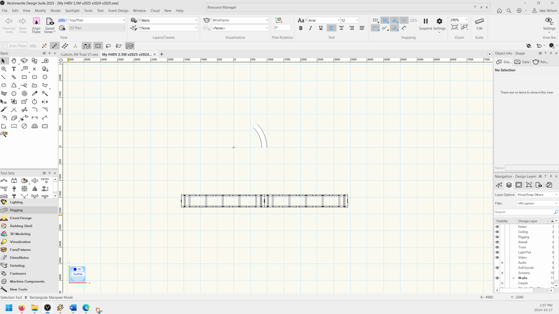

Jake Wilson Posted October 31, 2024 Author Share Posted October 31, 2024 Hi Scott, Thank you for the video, I will make these changes and hope for the best. This Triangle issue only appeared after I updated to VW 2025, until now I have never had a problem adding truss to a drawing. The very first time I tried to use the new truss tool in VW 2025 the triangle appeared, I have not assigned it to anything or assigned anything to it. I have also noticed that when I open old drawings, like to custom truss project I spoke to Justin VW about, to update them, a section of curved wall appears. I did not place it or activate the wall tool, I almost never use the curved wall tool. 2025 needs a close examination 1 Quote Link to comment
Vectorworks, Inc Employee Scott C. Parker Posted November 1, 2024 Vectorworks, Inc Employee Share Posted November 1, 2024 13 hours ago, Jake Wilson said: issue only appeared after I updated to VW 2025, Hi Jake, I completely understand. I once opened an old file to find an entertainment object, thinking it was a kitchen cabinet. The file was so old that some item internal flag had before corrupted and caused an identity crises. I looked at the sample file you shared; it was originally built seven versions ago. When I encounter this in my files, I open both the old file and a new blank document. I then import layers from the old file into the new one, and this often leaves the odd stuff behind. You'll get the dialog asking if you want to use the old records and information or the new information/settings offered by the newer file. Always choose the new information from the current file. Yes, this will take a bit of time, but the reduction in frustration and the improved performance of current file data will be worth the effort. 2 Quote Link to comment
