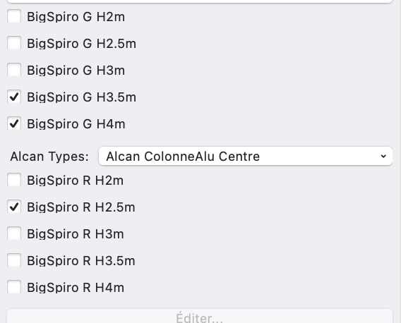

Raph Posted October 16, 2024 Share Posted October 16, 2024 (edited) Hello everyone, here's a new question.... I'd like to be able to make groups or, and, above all, sort the options according to my choices. Currently, alphabetical order is preferred... grrr how do I sort the item info palette? Is there a trick? Thanks Edited October 16, 2024 by Raph Quote Link to comment
Jesse Cogswell Posted October 16, 2024 Share Posted October 16, 2024 I haven't really used Marionette for a couple of years, so it might have changed, but as far as I know, the OIP will always appear in alphabetical order. One trick that I've used is adding numbers to the front of all of the named variables in the order that I would like them to appear. Such as "01 - BigSpiro G H4m". It's a little clunky, but it was the only way I found that works. Quote Link to comment
the frog Posted October 17, 2024 Share Posted October 17, 2024 you just have to add the number (1 2 3 4....) before the node name if you look at my post about "objects in front or in back" the nodes are ordered in the OIP Quote Link to comment
Raph Posted October 21, 2024 Author Share Posted October 21, 2024 Thanks for your answers yes of course putting a number is a simple and effective solution! I was wondering if there is a solution to do it in a hidden way? I remember another parametric symbol where I tried to place a “_” before the name of the parameter entry. But it doesn't work! Another question .... is it possible to make groups? In this case, it's a matter of placing symbols on the left or right. Would it be possible to make one group for right- and another for left- heights? Thanke in advance Quote Link to comment

the frog Posted October 21, 2024 Share Posted October 21, 2024 Ok this is sorted now what kind of group do you want ? this is pretty easy to use this way. Tell me Quote Link to comment
Raph Posted October 21, 2024 Author Share Posted October 21, 2024 how waou How did you do it? This way is already good! I wonder if it's possible to have groups like delimited containers but ... separated this way is fine thanks Quote Link to comment
the frog Posted October 22, 2024 Share Posted October 22, 2024 Here is the file with the changes. Because the whole script is in the node "Alcan with big spiro" it is very difficult to group the properties. AlcanForum_v1_v2023.vwx Quote Link to comment
Raph Posted October 23, 2024 Author Share Posted October 23, 2024 Hello Thanks for this addition ah... it's just done with a number what I didn't understand is that the number is not visible!!! Thank you Quote Link to comment
