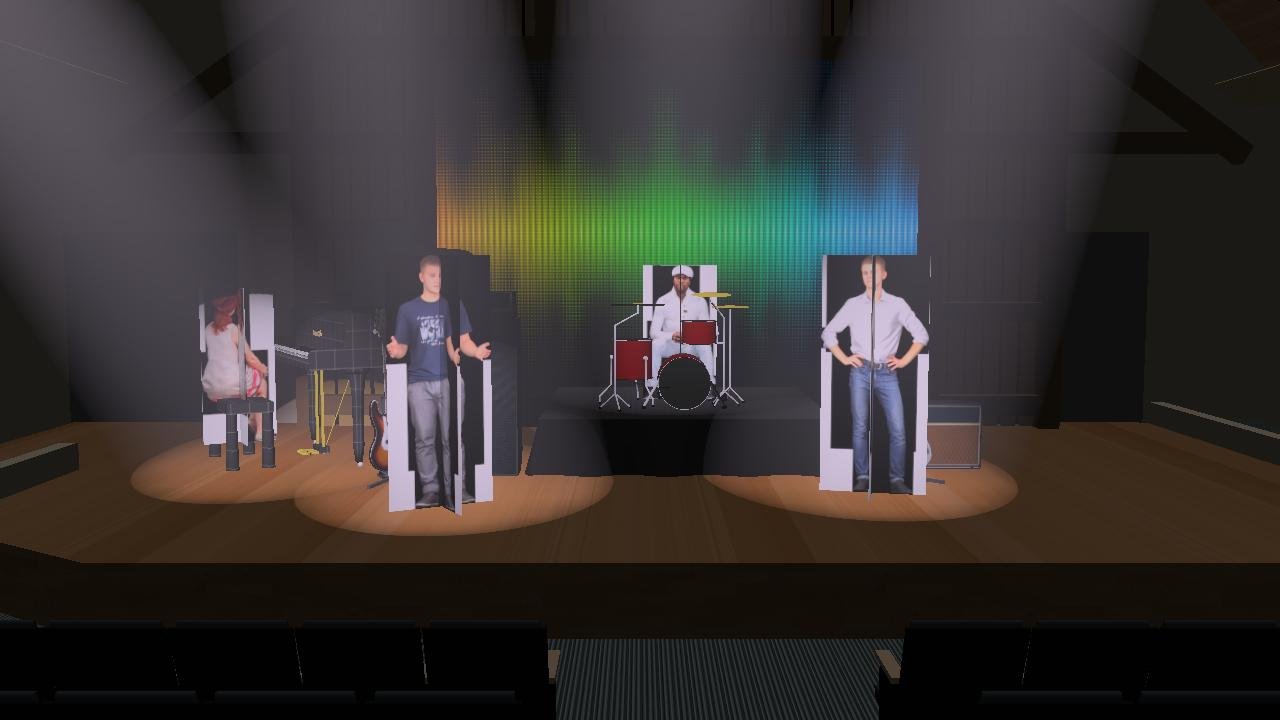

Josh B Rawls Posted October 13, 2024 Share Posted October 13, 2024 Any reason the 3D people imported from VW look like this in Vision? I know I can place people directly in VW, but it's easier for me to get everything set correctly in VW. Quote Link to comment
Vectorworks, Inc Employee TomWhiteLight Posted October 14, 2024 Vectorworks, Inc Employee Share Posted October 14, 2024 Yes, these people are image props, use 3d models instead. The textures on the image props have an alpha channel in VW, Its likely the texture will need to be re-defined in Vision I will defer to my colleagues to confirm. Easiest to use different models to be honest. 2 Quote Link to comment
E|FA Posted October 14, 2024 Share Posted October 14, 2024 Here's an explanation of image props: https://app-help.vectorworks.net/2024/eng/VW2024_Guide/Textures/Creating_image_prop objects.htm 1 Quote Link to comment
