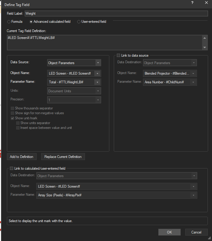

C. Andrew Dunning Posted October 2, 2024 Share Posted October 2, 2024 Good morning! Given the following equation, what is the syntax to control the displayed precision? Everything I have tried either a) has no effect or b) displays additional text instead of performing a mathematical function. I have gone back-and-forth through old posts, here, to no avail. (#BrxHoist#.#WeightWithChain#+#BrxHoist#.#RoofForceNoDeadloadWeight#)*0.002205 TIA... Quote Link to comment

Bluetones Posted April 14 Share Posted April 14 I came to the forum to try to find how to fix (almost) this exact problem. LED tool, custom Data Tag, wacky precision error: The Define Tag Field doesn't let me adjust the precision and I get WAY too many decimal points! 😜 So I tried your solution, adding #prec_)# to the Definaition. No good. Depending on where I put it in the feild, I either got no response, or no data. (Blank or 0.) So I defined the field with the parts that make up the TTLWeight data; Weight + Hardware, with the precision hashtags: This works. But I think that there's a bug in the calculations of TTLWeight, that then leads to the ridiculous decimal point errors. Just thought you all might enjoy my journey... Happy drafting! Quote Link to comment
