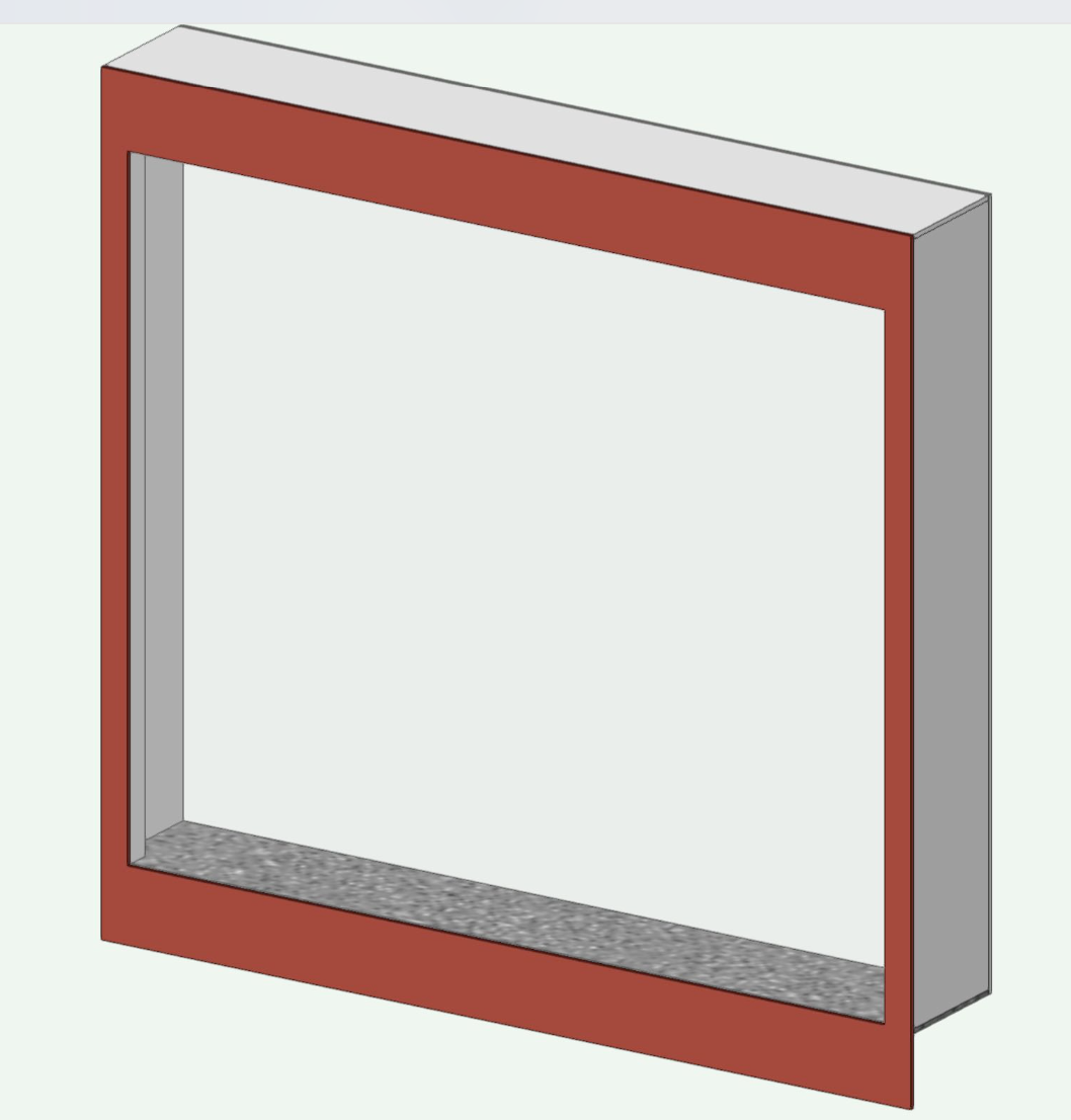

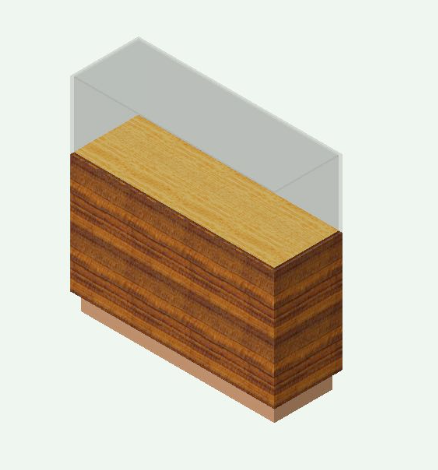

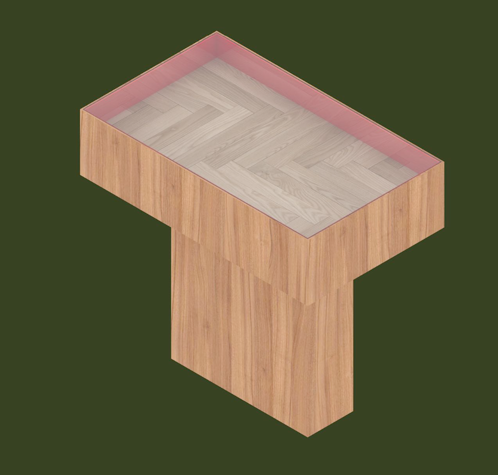

the frog Posted December 2, 2024 Share Posted December 2, 2024 Hello about your last post, if you look in the Marionette objects, I built some vitrines in 2019. At the time textures where (and are still) a bit random. Otherwise the scripts works. Have a look... Quote Link to comment
